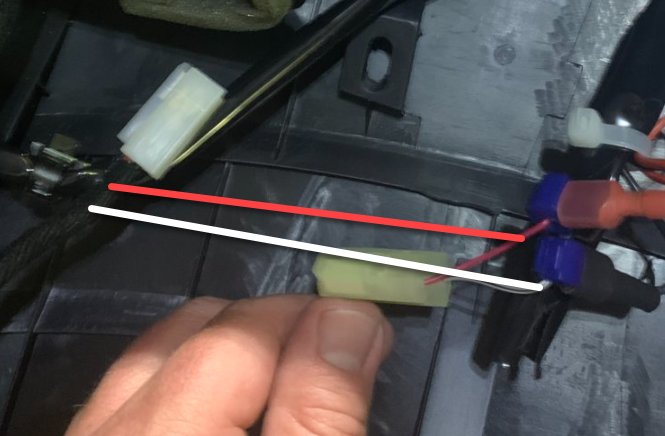

    9AB237D5-36C6-4AC4-BE95-1CF431B44A8C.jpg Hey all, need some help. I’m installing the wireless charging tray and having trouble with the connections on the harness. I changed my cig outlet to a usb outlet, so the harness for the wireless tray doesn’t match up. Anyone else done this with the usb mod? Here’s a picture of what I have. The red and black connectors are coming off the rear of the usb connection that I installed. So there’s no place for the white connector on the charging tray harness to connect to. Any help appreciated!

    Cut it off (or leave it) and splice it like you did the USB

    Ok so I’ve gotta splice into the wires coming off the back of the usb into the wires of the white connector off the wireless tray harness, correct?

    You can just jump the connection. Just like below
    You're basically doing the same wiring as your USB but for the wireless charger

    10-4. Thank you! Wiring isn’t my thing so I appreciate the help.
