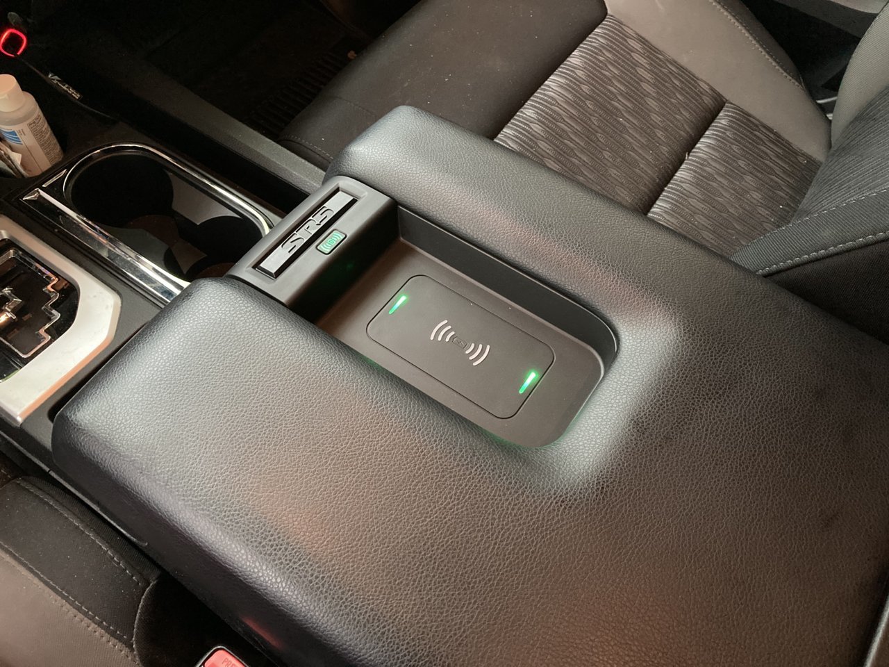

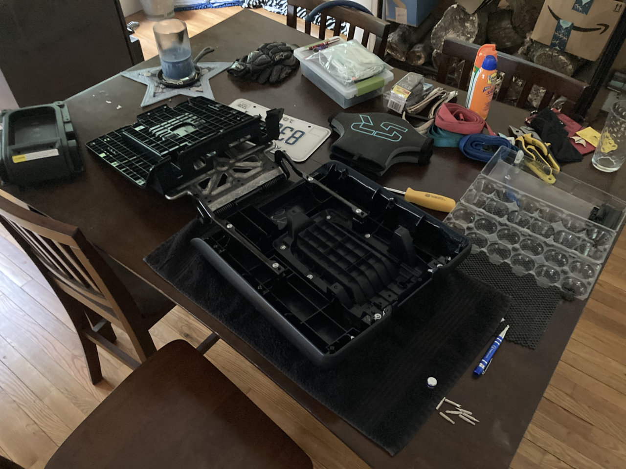

    The harness comes with the OEM charger, has a splitter and taps into the power for the console power supply for the rear passengers. Plugs right in. I installed mine this summer and only took about 40 mins.
