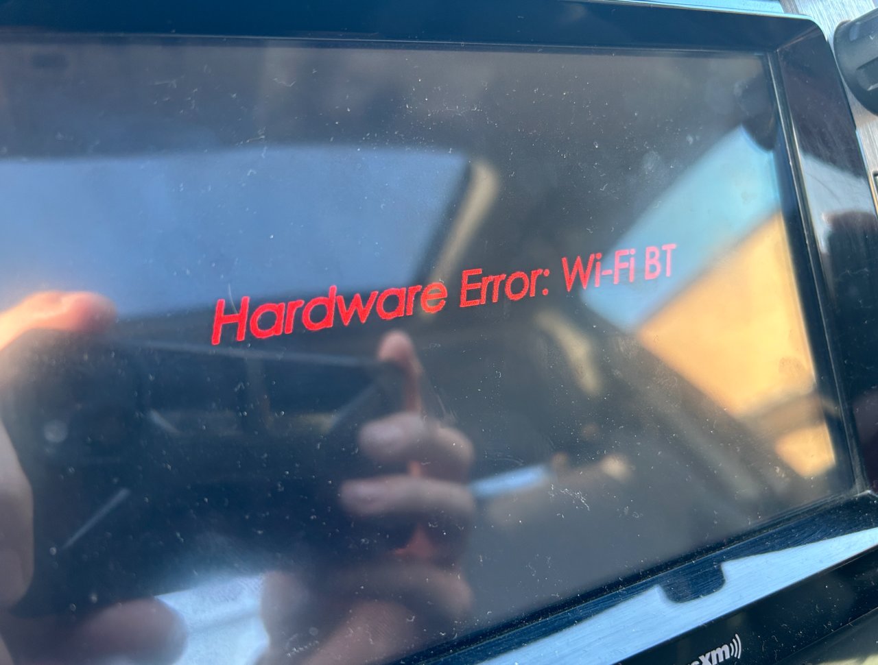

    I have a Kenwood DNT 1007XR Head Unit I replaced my factory unity with. I still have a boot up lag (10-20 sec) and the whole unit will randomly reboot. Phone disconnects and the Head Unit restarts. I have better operation with Apple Car Play than I did with Android Auto...
