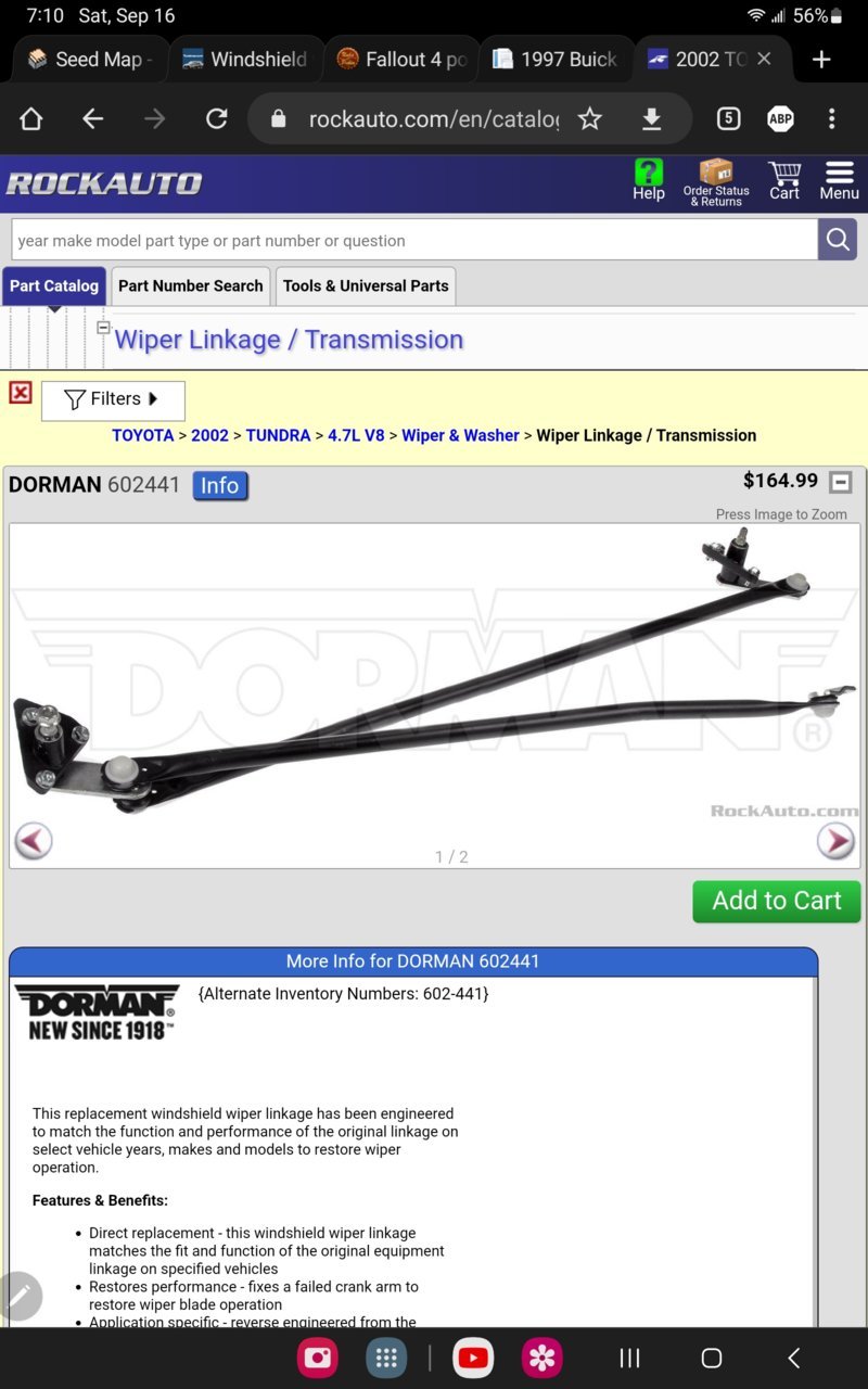

    This part?

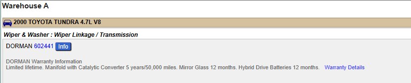

    This is what I bought from them and it was $10 more back then
