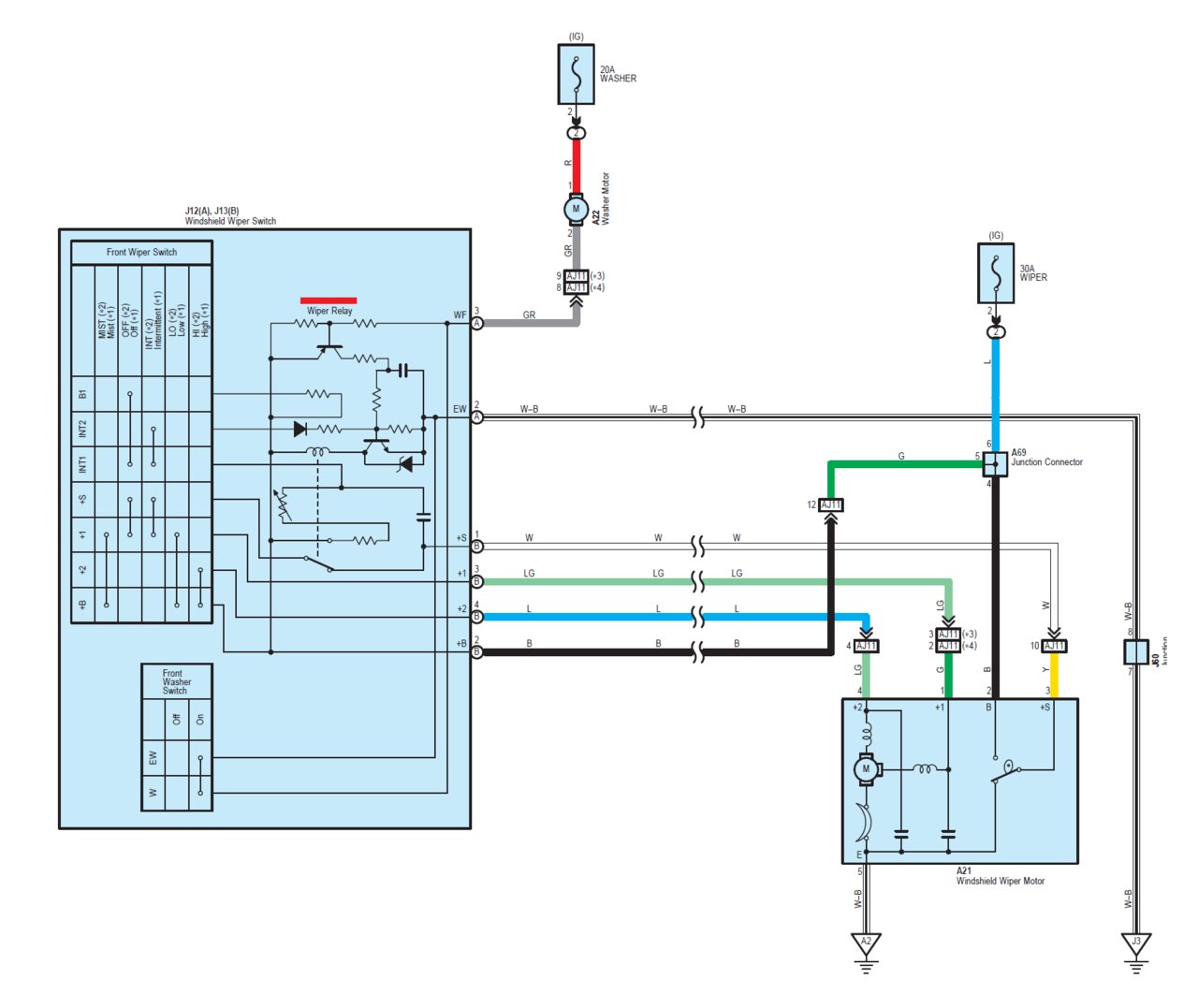

    If you have the Front Wipe with Intermittent it has the relay but its inside the switch like the dealer said. I marked a red line above it here.
    If you have verified bot the 20A Washer and 30A Wiper fuses are good, I would check the two ground wires coming from the switch. Make sure you dont have a broken or loose wire somewhere. If you dont it could be safe to assume an internal failure in the switch assembly its self. If you are good with a multimeter you could study this diagram, and then test the switch with the meter to make sure it is all working.
    There is no external relay that you can just remove and replaced. It will be soldered onto a circuit board inside the switch.

    Thank you for your reply. I visited the dealership this morning. After running the diagnostics it was determined the switch was not being found. End result they removed the connector to the harness. There was corrosion on the connector. They cleaned it and applied dielectric grease to prevent further corrosion. The wiper switch is working fine. The technician stated he had never seen this before. A learning opportunity for all of us.
