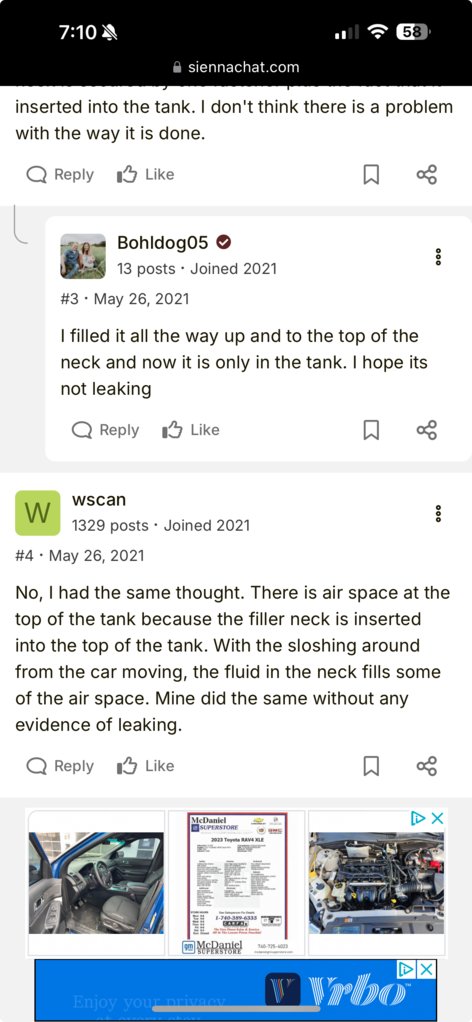

    i saw someone post this from 2015.

    Still no updates . Could it
    Possibly be air pockets?
