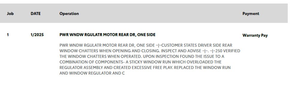

    it has happened on all 4 of my windows. Passenger front got a new window run and that fixed it. Driver's rear got the same and it did not fix it. The ordered a new motor and that did the trick. I think the dealer write up said something like window run being tight caused the motor to become damaged/loose or something like that.
    Edit:
