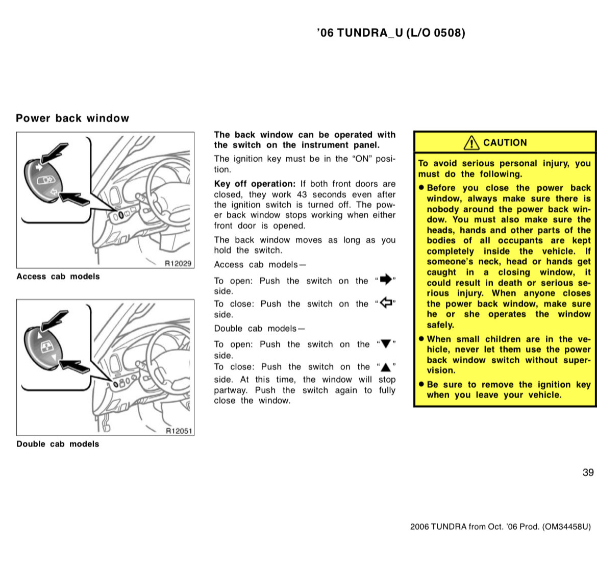

    This happens to me on my rear back window. It stops half way and I have to give the button another push for it to go all the way up.

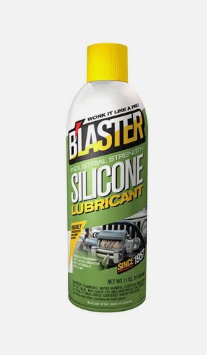

    Spray silicone generously in the window channels
    FJ432[OP] likes this.

    if you are talking about the rear sliding window in the back, its supposed to do that. It stops half way when coming up as a safety feature. I thought mine kept getting stuck too but then I did some research and found out it’s designed to do that
    BubbaW likes this.

    3,826
    Bubba
    Where Eagles Nest
    04 DC LTD 4X4 4.7 V8
    T150 Lover
    itsWarrior likes this.

    I wanted to finalize this thread by thanking those above who helped me. The end result was bittersweet. On the passenger side I was able to use silicone lubricant and the window has no binds and operates as it should. The driver's side still doesn't function properly and I can hear that the motor is going out. It only makes sense that driver's window was used more frequently by the previous owner (the cab smells like an ashtray) so I will take a 50% success rate. A Dorman replacement motor has been ordered and I will watch some YouTube videos on the steps required to complete this task.
