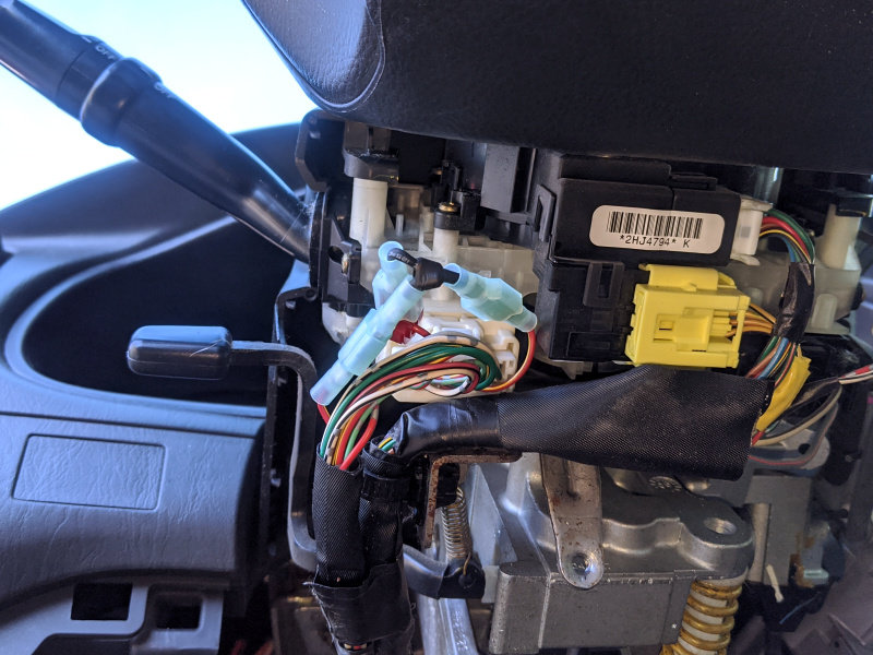

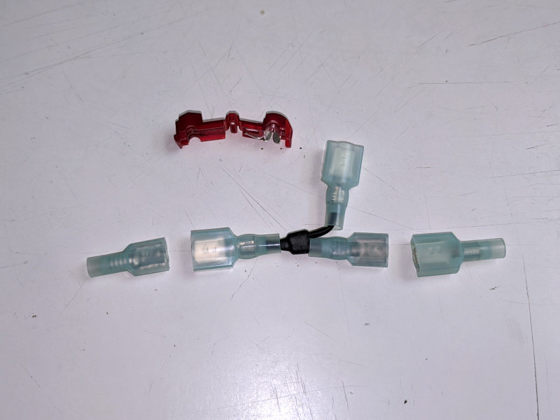

    Fog light is normally tied into the low beam circuit, coming out of the headlight switch.
    I tapped into both low and high beam, and isolated them by using diodes. This prevents triggering both low and high beams at the same time, when you have tied them together to feed the fog light relay.
