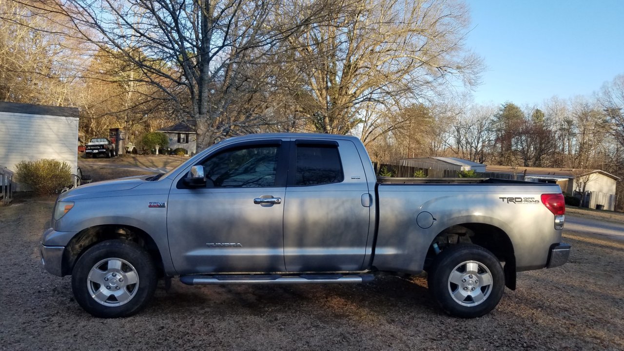

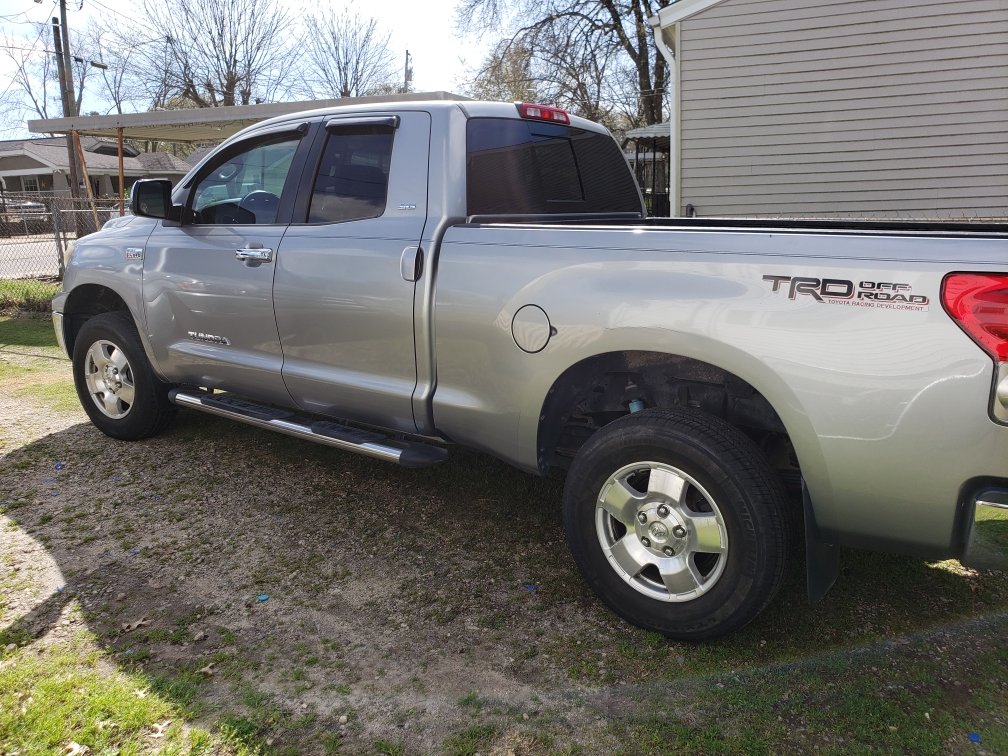

    I bought some Kanati mud hogs 295 60r20 with 20x9 wheels 0 offset. I bought my tundra a couple of months ago from a small dealer. It has a lift but I'm not 100% sure what the lifted inches are I measured a friends 2010 stock tundra and it looks like my truck is about 2 inches higher. So i guess it's a 2" lift that's been leveled because the front isn't as lifted as the back.
    My question is will these tires and wheels fit? I void a refund if I mount these tires to the wheels. Any help would be appreciated, Once again tires are basically 33"x12.50R20 and Wheels are 20x9 with 0 offset

    Thanks for the quick reply I can post some pics so give you a better idea of the lift. I thought kind of the same thing. Are spacers my best option for the width? I have removed mud flaps already, can I cut some cab mount?

    Cool, Thanks for the info. I was hoping I wouldnt have to send these tires back, I got a good deal with free shipping. If all I need is to make some cuts I will get them mounted and go from there. The tires and wheels I currently have on in the pics are so close to the uca I was almost certain the mud hogs would be a width problem. I dont know the offset of the stock wheel though that's on it so what do I know lol thanks again!!
