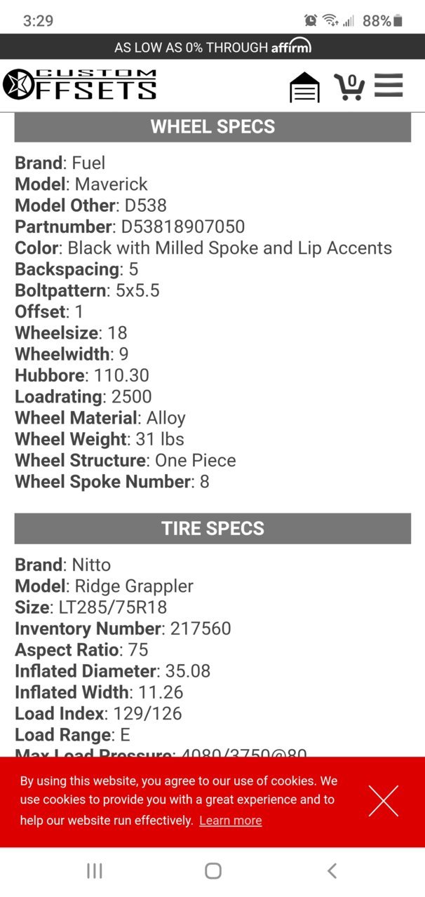

    I have a 2014 CM. Bilstien 6112 all the way up in the front to level it. Curious if this will work. 2 days of research and the shops just want to sell what they carry plus a spacer lift.

    Shouldn’t be a problem
    I’m running a comparable setup 295/70/18 0 offset wheels with a 3/1 level with no BMC and only occasionally get rubbing on full lock reverse

    Are you talking about the wheel tire combo or the exact wheel specs. 5x5.5/5x127 will not fit the Tundra. As for 0 offset, you'll need some mods.

    I meant to put on the 18x9 5x150 with an 18 offset.
