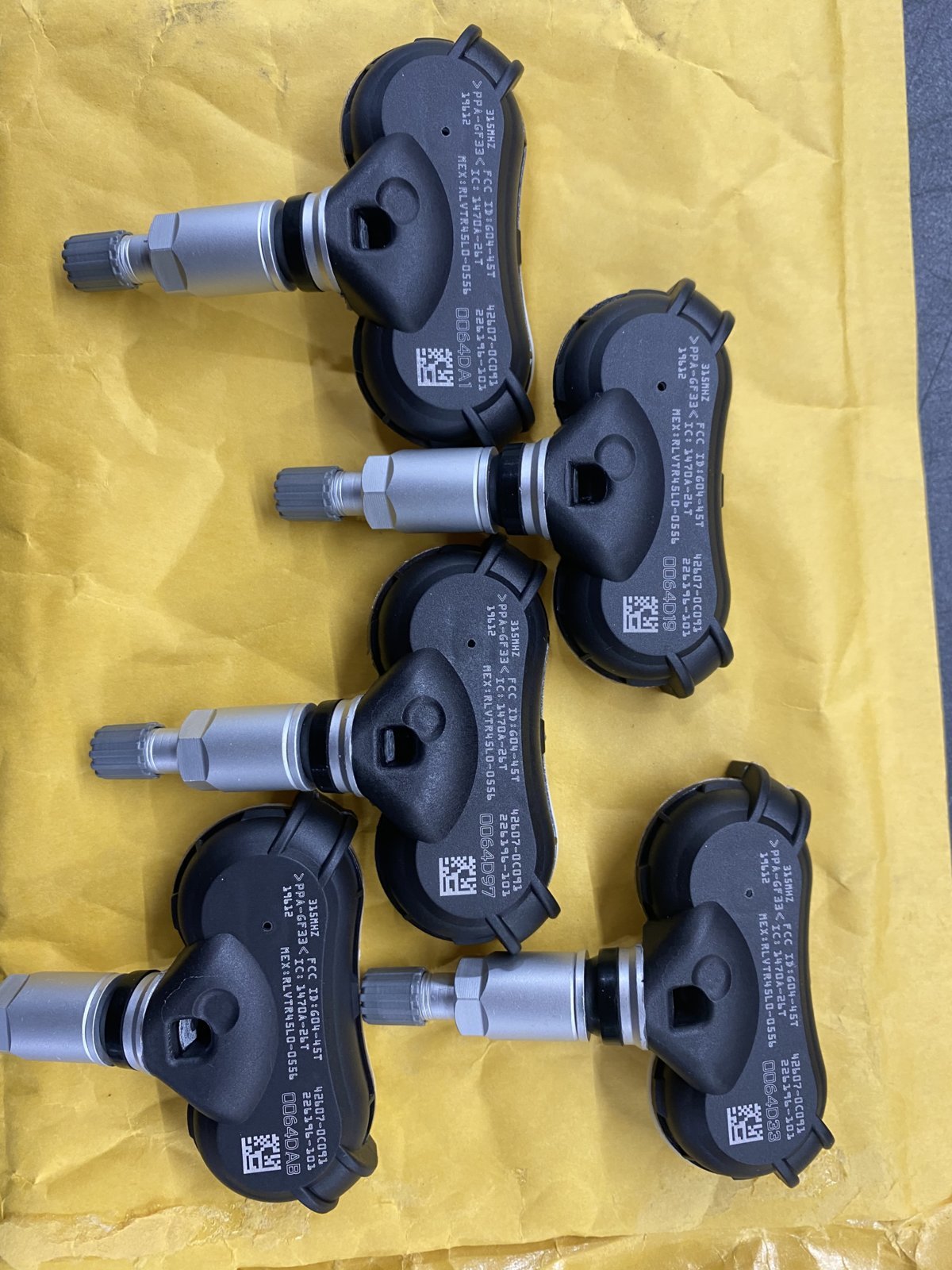

    My understanding in ‘17 and older, ‘18 & ‘19, and then ‘20 & ‘21 were the three different TPMS iterations for 2nd (and 2.5 gen) Tundras. I may be off my rocker though…
    I do know that my new (still not yet installed) sensors for my 2018 have 7-digit codes. That is also what Techstream shows for my OEM ones. Earlier years were 8-digit.
    Here are my 5 new ones. 315mhz.
