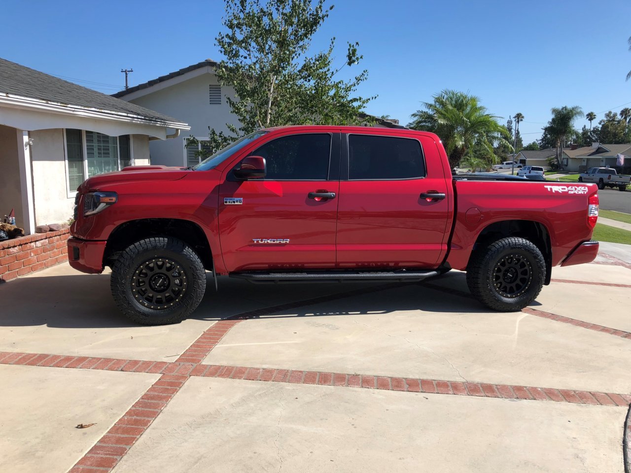

    Lifted.jpg Mine on the top setting. Prolly a 1/4" difference
    PRO19[OP] likes this.
