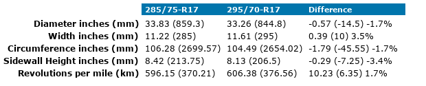

    Might I recommend 285/75/17
    Best of both worlds, tall tire but not too wide keeping rolling resistance lower.

    I like @14burrito's suggestion. 285 75 17. Fairly large and shouldn't give you too much trouble fitting. Otherwise, 35x11.50... but you'll need to trim some.
