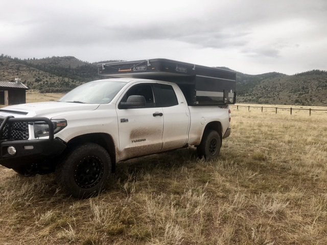

    It is heavier but amazing.. I got to use other day on a deer, not by choice. Little blood splatter but truck is fine. I have the 6112 at 1.9. Rides fine

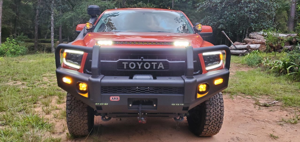

    If you start adding weight on the bumper like another 80 pounds of winch up there you'll feel the difference. I had to fix it but my shocks I think had 100k+ miles on them.
    If you can use them, I have a set of old man Emu heavy load coil springs I was going to use but ended up replacing my whole setup with kings with 700lb eibach springs.
    I love my ARB bumper. Check out the new Dobinsons bumper though before you order.

    If you're talking about the scoop like from a PRO then definitely no interference. The bar doesn't interfere with the bulge light I have in at all.
