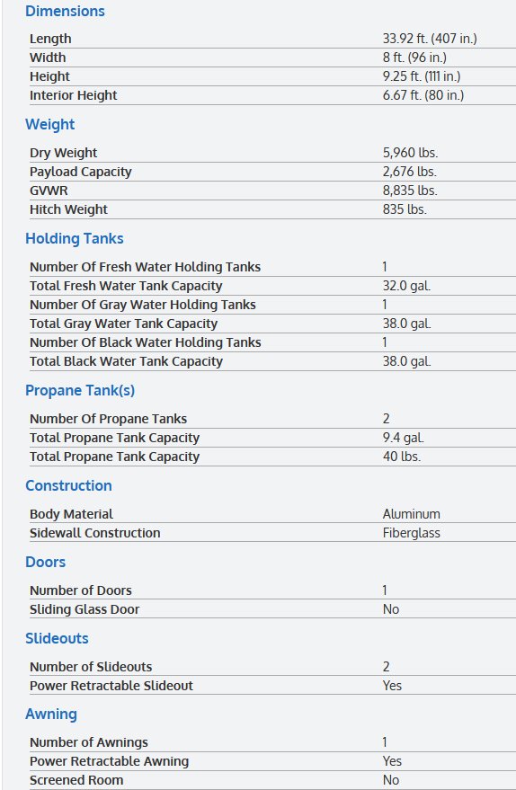

    I have some good news for you, and maybe not the best news.
    You are not over the Tundra Gross Vehicle Weight rating. The 8835 lbs is the max the trailer can weigh.
    The hitch weight is going to soak up a good portion of your trucks capacity (the GVRW and GAWR).
    That is a lot of ass behind you, but luckily you are in a low elevation location without any mountain passes.
