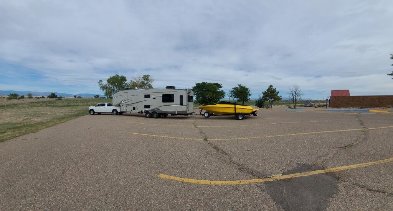

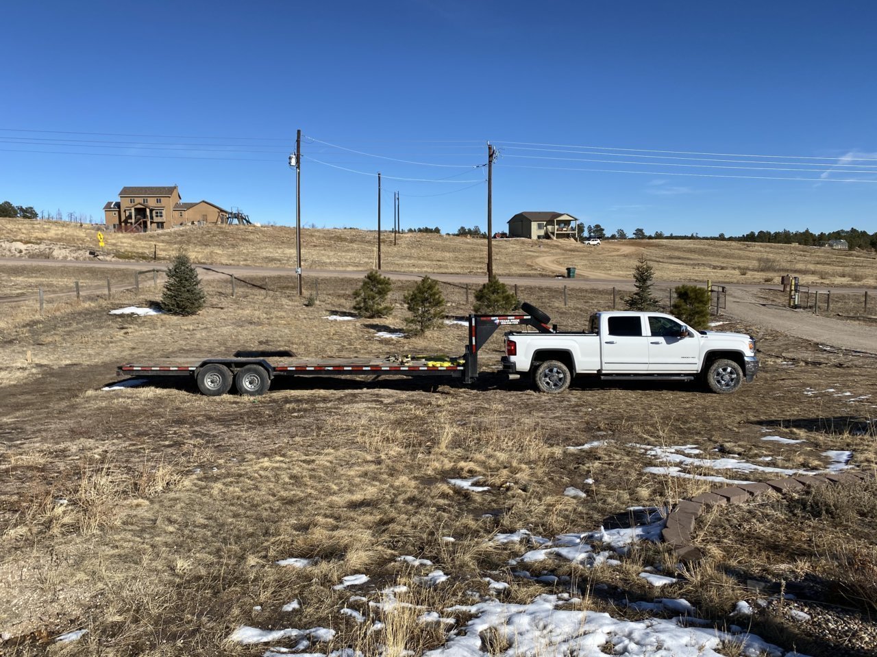

    This is 28'
    That's a lot of ass behind a 1/2 ton.
