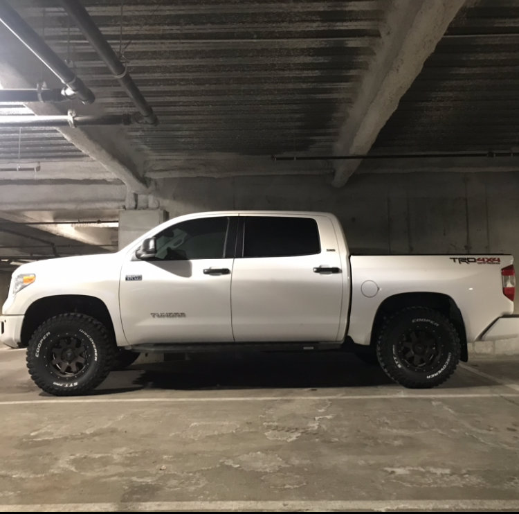

    hello all,
    I just installed Camburg leveling kits over the weekend and it seems like my truck is about an inch nose high. My question is does it settle half an inch or so and how long does it take to settle? Thanks in advance.

    163,480
    It can take a bit to settle down

    According to Fox no, and I agree. Have beat mine pretty good off road, and it settled maybe 1/16”. Looks like there is plenty of room to lower it, and imo you need to, will be topping them out on potholes and bumps. Your shocks are only good for 2 inch lift per Fox, although it is only possible to go down to 2.5” before the coil is free at droop.

    Looks like a lot of preload to me. How much preload is the recommended limit not to pass?

    No measurement, just 2” lift which is not possible. Here is how mine looked as low as they could possibly go without the coil being loose, about 2 3/8” lift.

    2” will level it. Even that can look nose high on my truck. So if @Vizsla says 2-1/2” minimum... it will never settle to level. Need to start thinking about thr rear. Or a winch bumper lol.

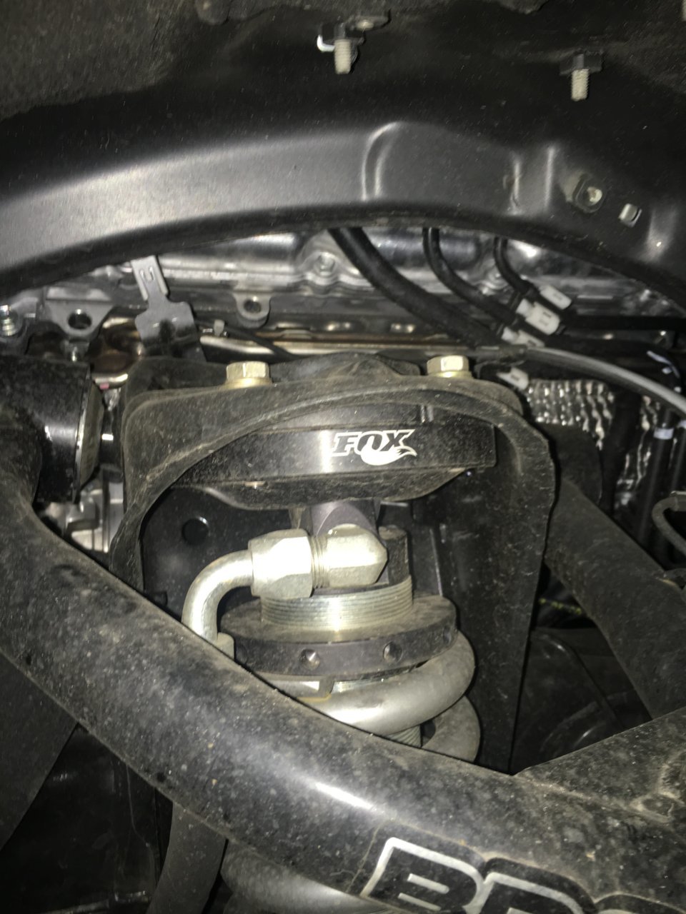

    How can you tell what height they’re set at if they’re already on the truck? And can they be turned down while on the truck?
    I’m asking because I’m wondering if mine were preset from fox at the highest setting. I have shims also to correct the lean and I just don’t want to be overextended.

    Whon installed them? If a shop did, maybe they turned them up because they like it tall
    Yes if you asjust the collars you need an alignment.
    You really can’t tell your lift height without pre-measurements. The proper way to measure is centerline of the hub to fender edge. This takes the tire size/inflation out of the equation.
    You can turn them down while mounted. Jack up the truck until tire leaves ground. Take out the set screw, then use spanner wrench to spin collar up.
    bigzrs01 likes this.

    Thanks for that response. In addition, is there no indicator on the coilover as to which setting it’s at? I guess that’s what I was trying to ask. I guess I could always reach out to fox and ask as well. Although when I ordered them trough my shop I had asked them to request that the coilovers be set at 2.5”. Now as far as if that was actually done I do not know. Only reason for all my questions lol. The ride quality isn’t bad, but it’s hard to tell if it’s any better or worse from stock as I had the suspension added shortly after getting the truck. I do have the DSC upgrade but haven’t messed around with those settings either.

    Good question as well. Unfortunately not. There is slight variation in all springs so it is possible that if we both set our collars the same, lift height could be different.

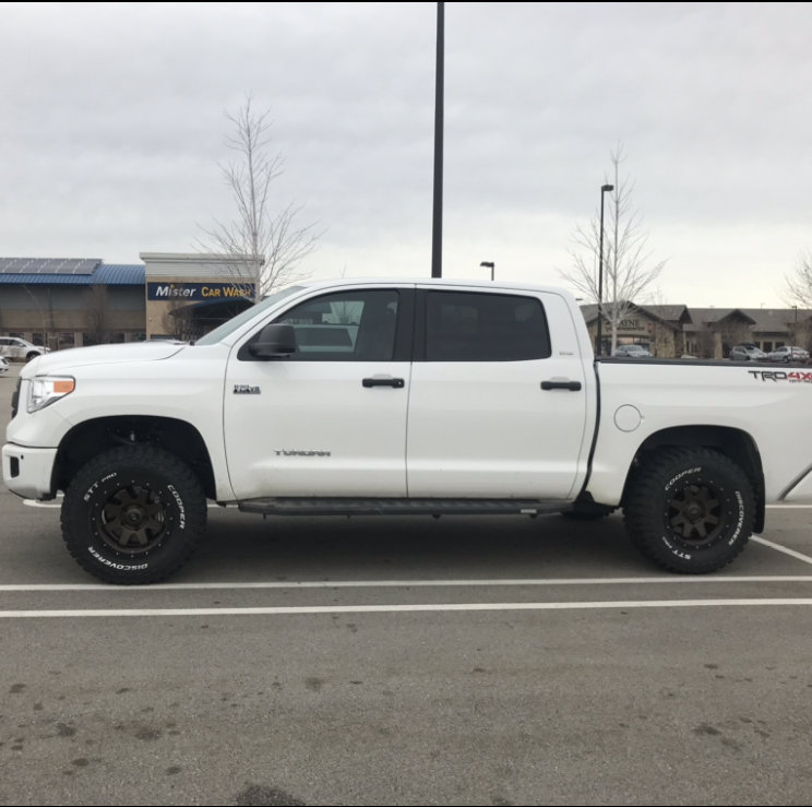

    I took a picture today and it looks a little bit level out. I’m loosing my mind here guys. Lol

    That’s about how mine looks even with a cb +3 in the rear lol. I think my front may be set too high.

    I think the front is just a little higher than the rear. put a level on the bedrail and see what it says.

    Lets say you opted for adjusting the C/O's. You gotta find a shop that can adjust with the truck on the lift and then they're gonna charge you by the hr by which most places are about 105-118hr and a alignment usually goes at least 100 - 125. So tax minimum is gonna be around $300. And don't expect them to get it right the 1st time so that hourly rate is gonna go up.
    Camburg shackle will set you back $200 and that same hr rate to install em. Don't compromise you ride comfort if you like what the ride is like with the front set like it is now because you'll end up in a alignment nightmare.

    If you like the front height, then raise the back.
    That’s what i would do. You got some nice looking tires so it will look right
