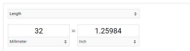

    Going from 18mm offset to 50mm is a 32mm change. It will move your tire in a little over an inch and a quarter. See image below.
    So go to your truck, crank it full lock (have somebody in it to hold it at full lock), and then measure all points of both tires and where they will be if they move inward 1.26 inches. Then turn the other direction and repeat. It's not perfect, but it will give you an idea of how your clearances will change.
