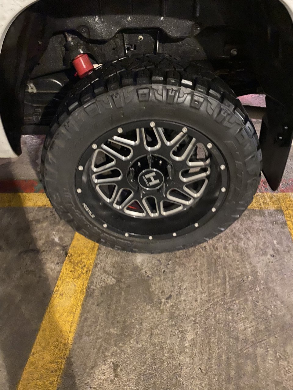

    Picked up a new to me 2020 Pro and it came with these tires and wheels already added. Wouldn’t have been my first choice for either but I’m wondering if I should just leave them alone for now. I’m not a fan of how far the sit outside the wheel well. But if they’re quality tires that would be fine for mild off-roading and over landing trails I’ll just leave them alone and move onto my next mod.
    275 55 R20
    Nitto ridge grapplers
    Thoughts?

    I've heard nothing but great things from the Nitto RG's for street and light off road use. I run terra grappler on my tacoma and they have been great.
    More aggressive off roading people go for trail gappler or mud grappler

    Those tires are fine. Many of us here run them.

    Aired down they are fantastic for the majority of off-road driving that 99% of people do. They are quiet on-road when new. However, I settled on the least aggressive Terra Grappler after burning through a set of the Ridge and Trail grapplers on my Tacoma.
    They will get extremely noisy if you don't have your pressures set perfectly for highway driving. Chalk test, keep an eye on your pressure through outside temperature changes, and rotate every 5000 miles.

    That is the stock tire size for factory 20" wheels like my 1794 has, so those are not oversized tires.
    Those are known good tires, many here run them.
    If they are poking out it is due to the wheel choice with less positive offset than stock.
    I would leave it alone for now due to cost personally, but that is up to you.
