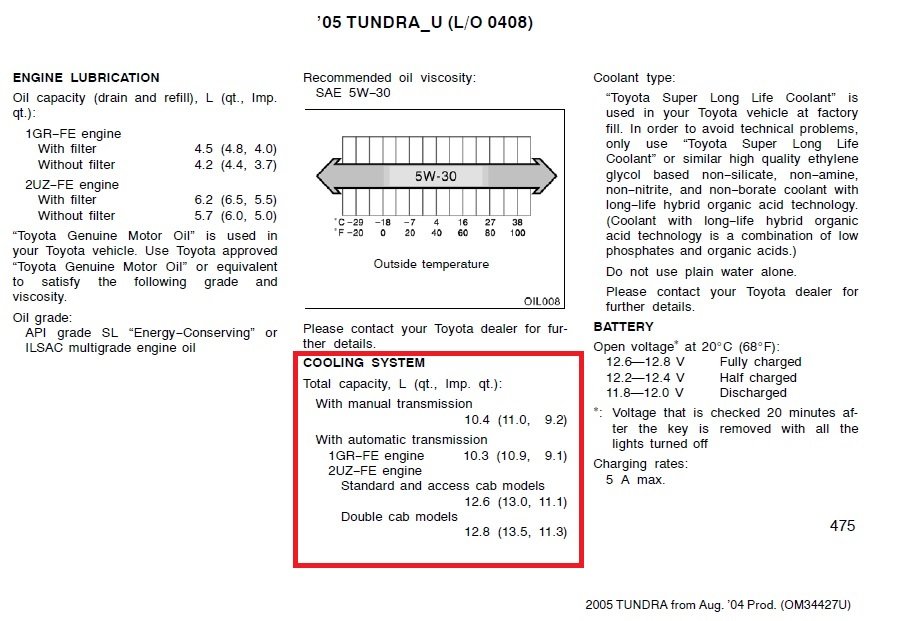

    You do you but given the capacity of an AC/RC compared to a DC is minimal, do you really want to go thru trouble of trying to mount a DC properly where an AC hangs and possibly have to find a DC shroud also.
    Sure ain't much bang for the buck.

    Interesting, that 1” only translates to 0.1qt, or less than half a cup of fluid. That would be about as much fluid capacity as you’d get if you cut 1” off the bottom of a beer/coke can.

    It's early but if we're to believe the OM, it's .5 qt or ~ 2 cups. I doubt seriously if 1/2 or 2 cups is gonna make that 2UZ any happier but the mind can play tricks on some folks.

    Only if you read the correct specs. :rofl:
    No coffee here yet. I was reading the manual vs auto numbers, 9.1/9.2
