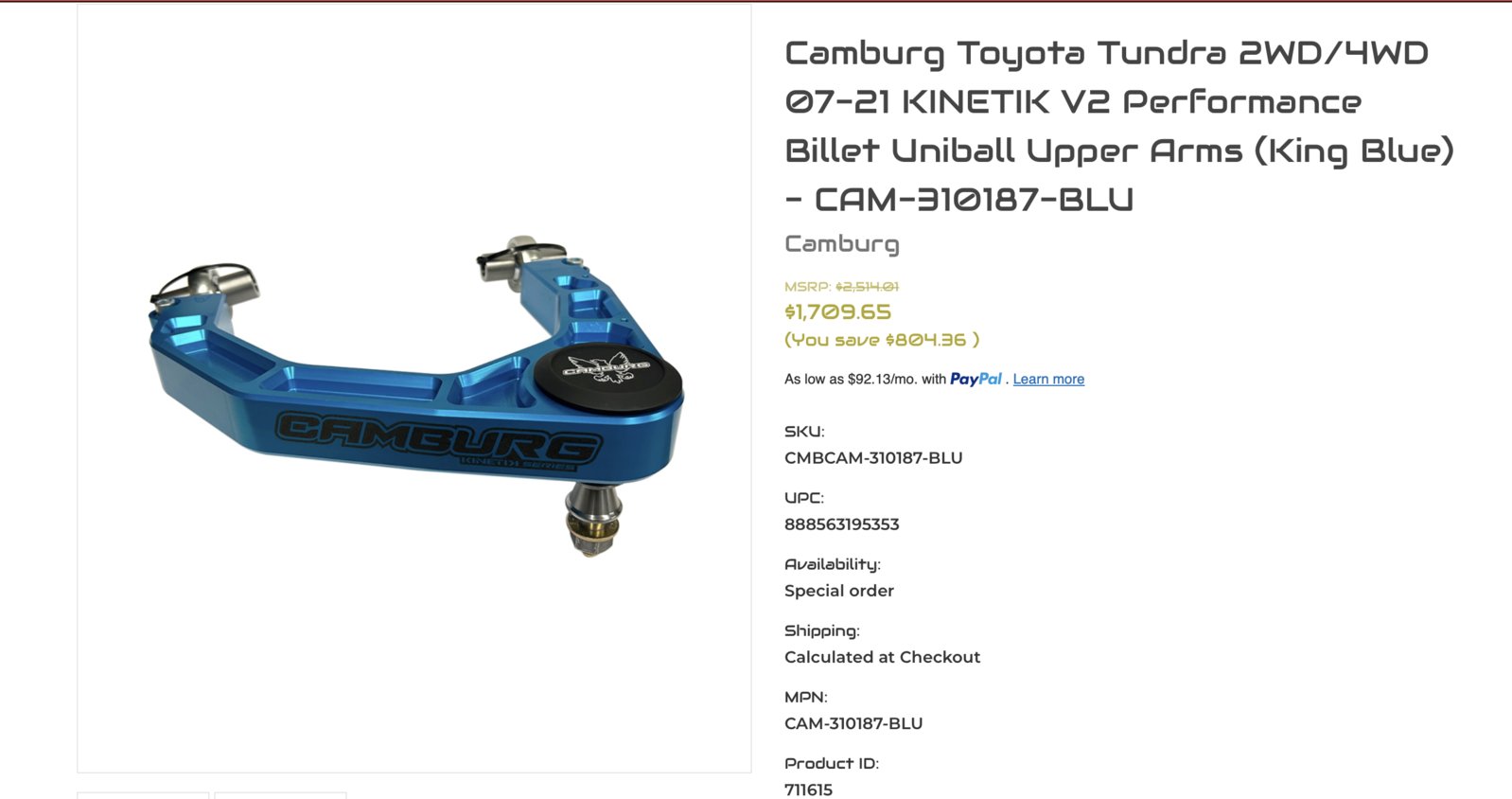

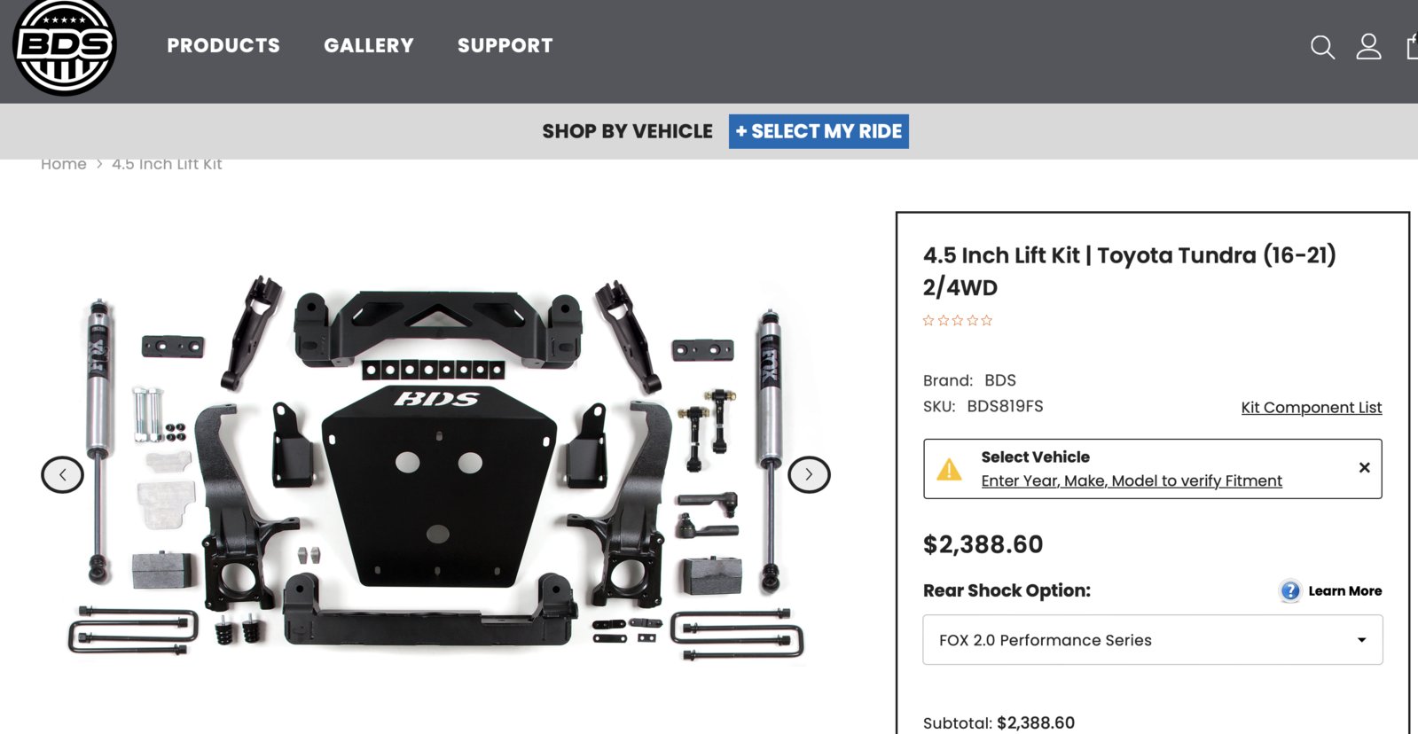

    I have looked through threads and seen some conflicting info. Does anyone know if the
    BDS 4.5 Inch Lift Kit | Toyota Tundra (16-21) 2/4WD (I am getting the version without the shocks since I am using my Kings instead)
    will be compatible with the following UCA? Camburg CAM-310187-BLU
    I read somewhere that the Camburg UCA was only for 1-3'' lift but now I can't find it.

    That’s a drop bracket kit. Take the 1-3” of lift factor out of the equation for the uca. Drop bracket kits essentially move eveything down and you’re utilizing your oem UCA. Hence why you don’t see any UCA’s in that package. You can use the camburgs, but they aren’t necessary

    THANK YOU! I knew I was missing, it just wasn't adding up. Appreciate the explanation
