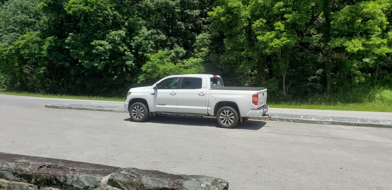

    20200711_130019.jpg I have the widepeaks at3 on mine with just a 1.75" leveling kit. They are 33's.

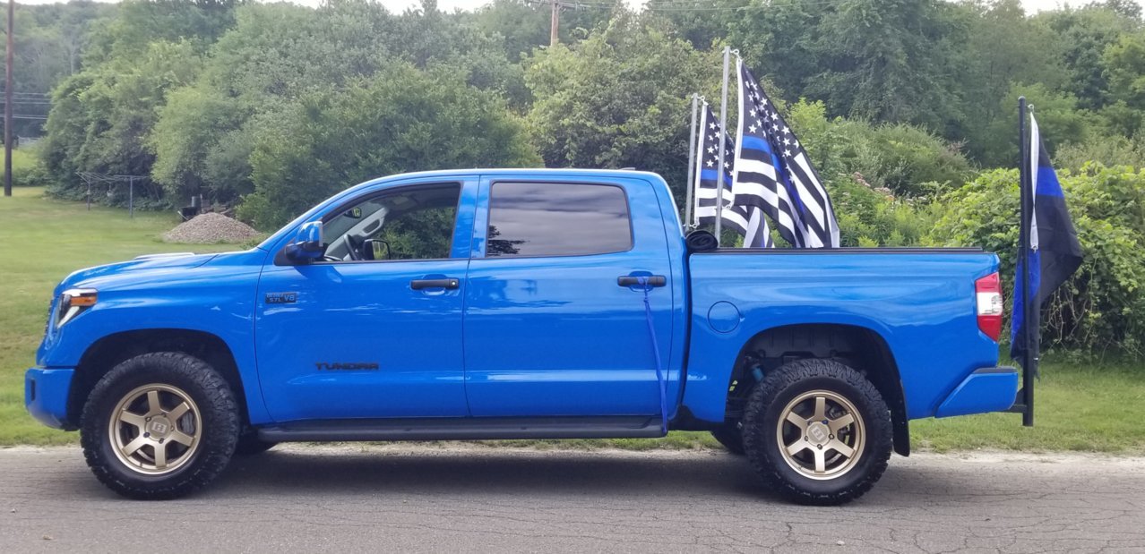

    I'm running 33x12.50x18 on +12mm offset, no lift, no rubbing, no cutting 2020 trd sport
    RobertD and Black Wolf like this.

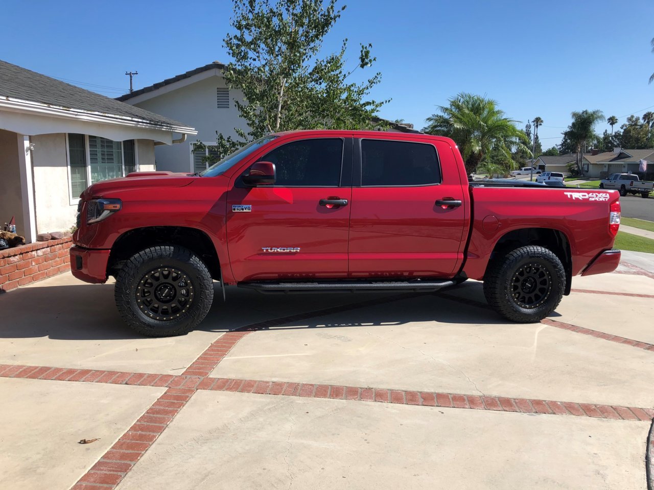

    I run 33s stock, no lift- 275/70-18

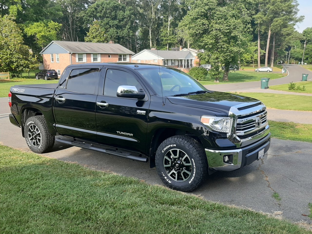

    305/65/18 Falcons with a 2.38" lift
