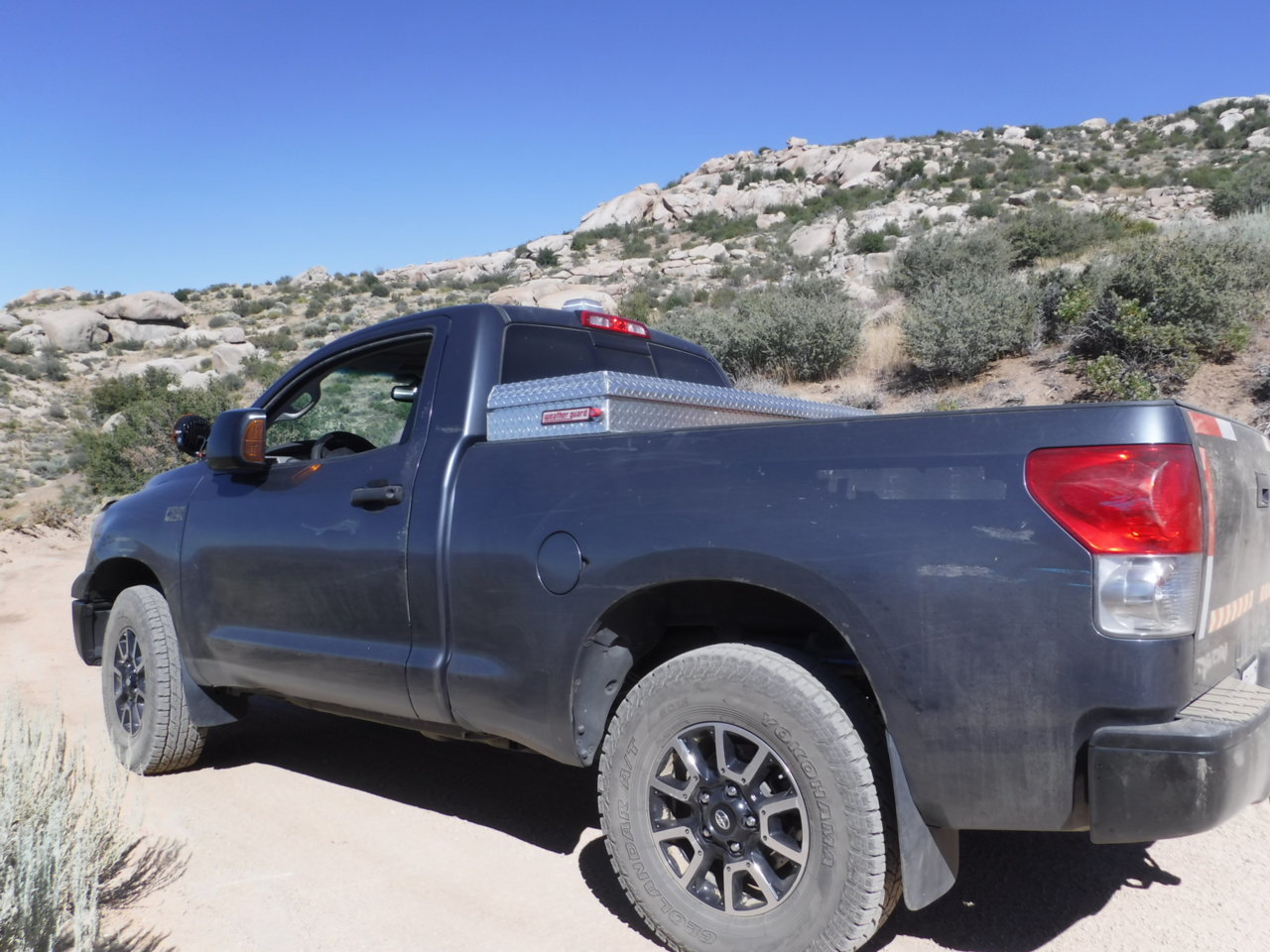

    My truck is lifted about 2" over stock with nothing added in the rear and I have no clearance issues.
