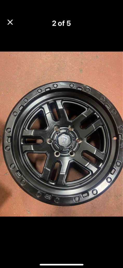

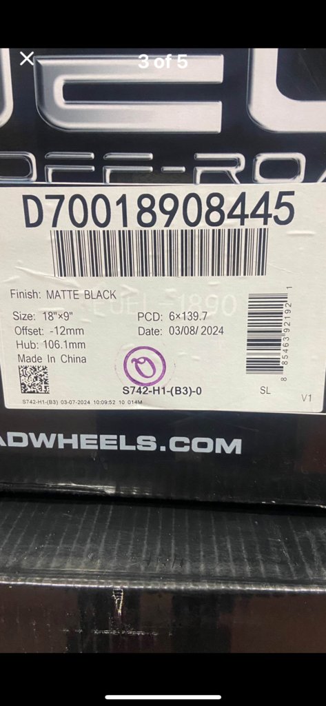

    IMG_1805.png IMG_1804.png IMG_1805.png Wondering if -12 offset Fuel wheels will work on my 2024 Tundra. Also these came off a 2024 Chevy and is the hub the same or would I need a hub spacer?

    Two things:
    1) Negative offset will poke. A lot.
    2) Chevy's have a really small hub bore IIRC. Somewhere around 78mm. Your Tundra is roughly 95. So no, they won't bolt up.

    Did you add the pic after my reply? I must be losing it.
    Revising my answer on point #2.
    They're aftermarket so the center bore ("Hub" on box label) dimension will generally (but not always) be oversized so that they can fit multiple vehicles with the use of hub centering rings.
    Not a hub spacer.
    If you got a 106.1mm to 95.1mm hub centering ring set, you could run these on your Tundra.
    Something like these:
    https://www.amazon.com/dp/B0B3LMVYH7/?coliid=I1XS7BE14QKSBL&colid=14LKYPG5KHE9R&th=1
    They'd still poke. A lot.
    If that doesn't bother you, go for it.
