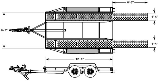

    Need to take with me behind motorhome. Looking for my options.
    Thanks

    Tundra is too heavy for most. Their max weight capacity is 5300 lbs.

    Looks too small by specs. Best way to be sure is to go to the uhaul place in person and check. They might even let you pull up on it if it’s close to try it out.
    Tundra
    229-248″ L x 80″ W x 76-77″ H
    Uhaul
    Dimensions
    • Deck Width 79.25"
    • Deck Length 148"
    • Deck Minimum Width 41"
    • Fender Height Off of Deck 12"
    • Between Ramp 44.25"
    • Outside of Ramp 76.25"
    • Ramp Length 77.5""
    • Deck Height 19"

    Considering my 1st gen double cab Tacoma barely fits. No

    It'll fit, with a few inches to spare... wheelbase is the main concern here. 145.7 in wheel base to 148. You will need to hook up them chains and extra straps

    Solution. My parents are gonna drive it up north and leave it there for me. No towing necessary!
    thanks for that unanimous maybe :rofl:
    a no a yes and a maybe. :monocle:
