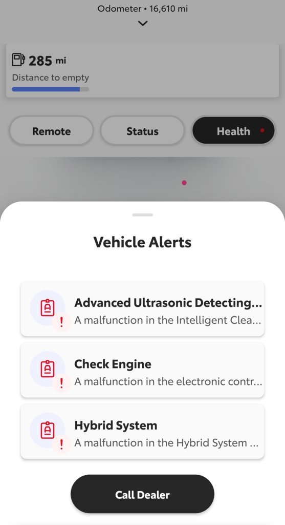

    Ordered a borla atak delivery April 2!!
    16k miles on it, bought in March 2024...

    And this person, same issue as me.
    "They said they will need to do a full short block rebuild. Apparently they are still waiting on some parts which they hope to have in another week, and then saying about 3 weeks to do the repair. So still hoping 1-2 months. Because mine is not on any recall list they will not do the crate motor. "
    Its on reddit... a rebuild...

    you can get this message due to anything...what happened?

    Should I remove all my mods? put all the stock exhaust and air intakes before I take it in? Or you think you'll be all right.

    Personally I wouldn’t give them any ammo to document. Go back to stock. Dealer tried to mark my Tacoma as aftermarket because it had trd. Made them correct it

    I got these same messages when I disconnected my battery jump point on my fuse block to install my Diode Dynamics light bar. After I hooked up the light bar and put the truck in drive I got all 3 messages and my heart sank. I also got the "visit the dealer for service" message. For S&G's I hooked up my very basic code reader and I had no codes and the messages went away. That was 6 months ago and I haven't seen any more warning messages.
    If you have access to a code reader I'd try that and erase all codes if even it doesn't show anything before removing all the mods you've made and scheduling service. Modern cars are so sensitive to any electrical drops or surges weird things can happen.

    So apparently one of the charge pipes got loose and I just plugged it in and retightened it now all I have is a check engine light and my car goes vroooooom!!! For now..

    I like to check my boost tube clamps every 3rd oil change to see if they need to be tightened.

    Guys keep saying its fixed...its technically not ....."all I have is a check engine light"

    If you undo the battery for 15 minutes it should clear all codes.....then just fire it up and see if the warnings return

    The check engine light was just a bank lean. Cleared.

    I had the same errors. My issue was the positive post in the fuse box under the hood was loose. Caused all the issues apparently. Also I’ve been told it isn’t an uncommon issue with other Toyota hybrids.
