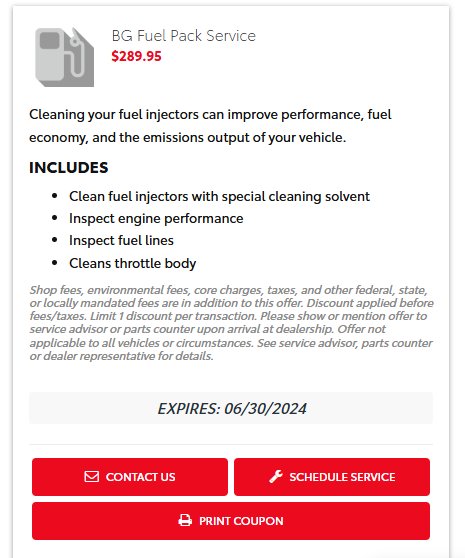

    I used to get 11.9 with 33" tires and a heavy foot.
    Since I had the fuel system cleaned, I'm getting 13.4..:thumbsup:

    What exactly did you do?

    Whatever it is the dealership does that I put off for 7 years.
    I never thought it did anything, but they said they did a MANUAL cleaning of the throttle body.
    Most said they would just pour something in the gas tank, which they probably did.
    I run a couple of cans of Seafoan once a year.
    I just know I got around 2.5 more MPG after it was done..
    I've got better things to do than do it myself..
