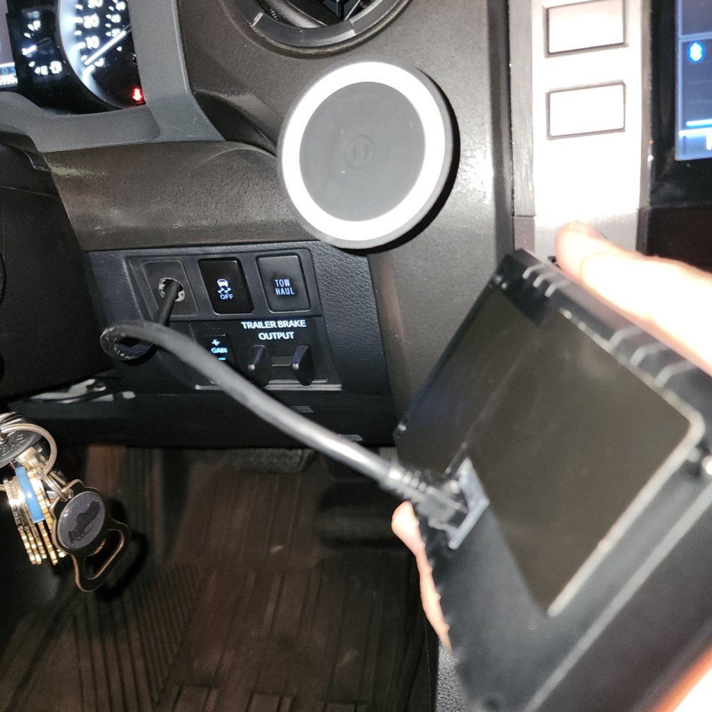

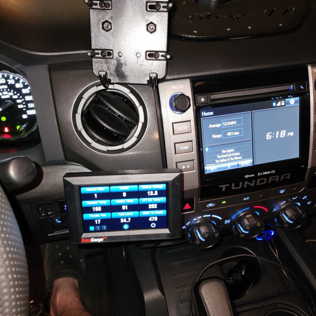

    Just got mine a couple weeks ago and still tinkering with all the options but I mounted mine here..

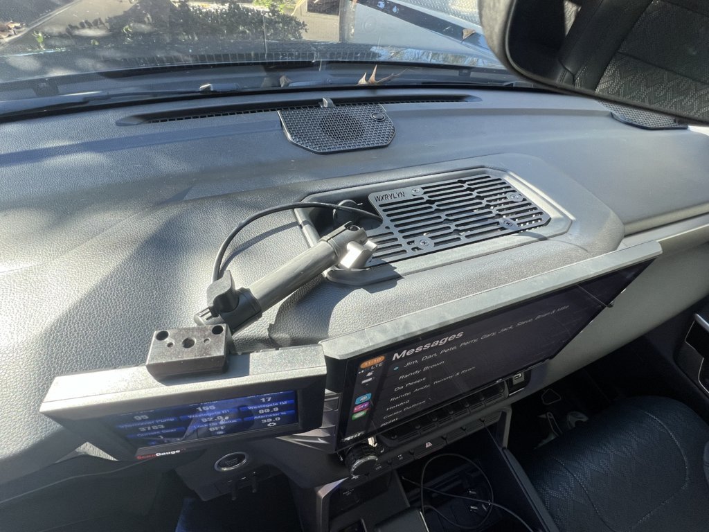

    Finished with the install this morning. Fairly easy overall.
    Had to remove the accessory tray behind the infotainment screen, and secured the mount u it into it. The kit came with everything needed to install. (Actually parts was off and only 4, instead of the 5 needed screws, washers and Nyla-nuts). There was a drill bit for the screws, a Phillips screwdriver and wrench to tighten these down. A mini lug wrench type tool to tighten the ball mounts to the frame when location was set. Directions were clear and easy to follow.
    This is a very nice system. Yes, a little pricey for my liking overall. But it is exactly what I was looking for and did the job perfectly.
    I really like this configuration. I did have to call Scangauge to figure out what I was too dumb to realize by not reading the directions. I had to go to setup and scan for Xgauge parameters, select all and save them. Then the transmission temp was available.
    Here are the pics promised.
