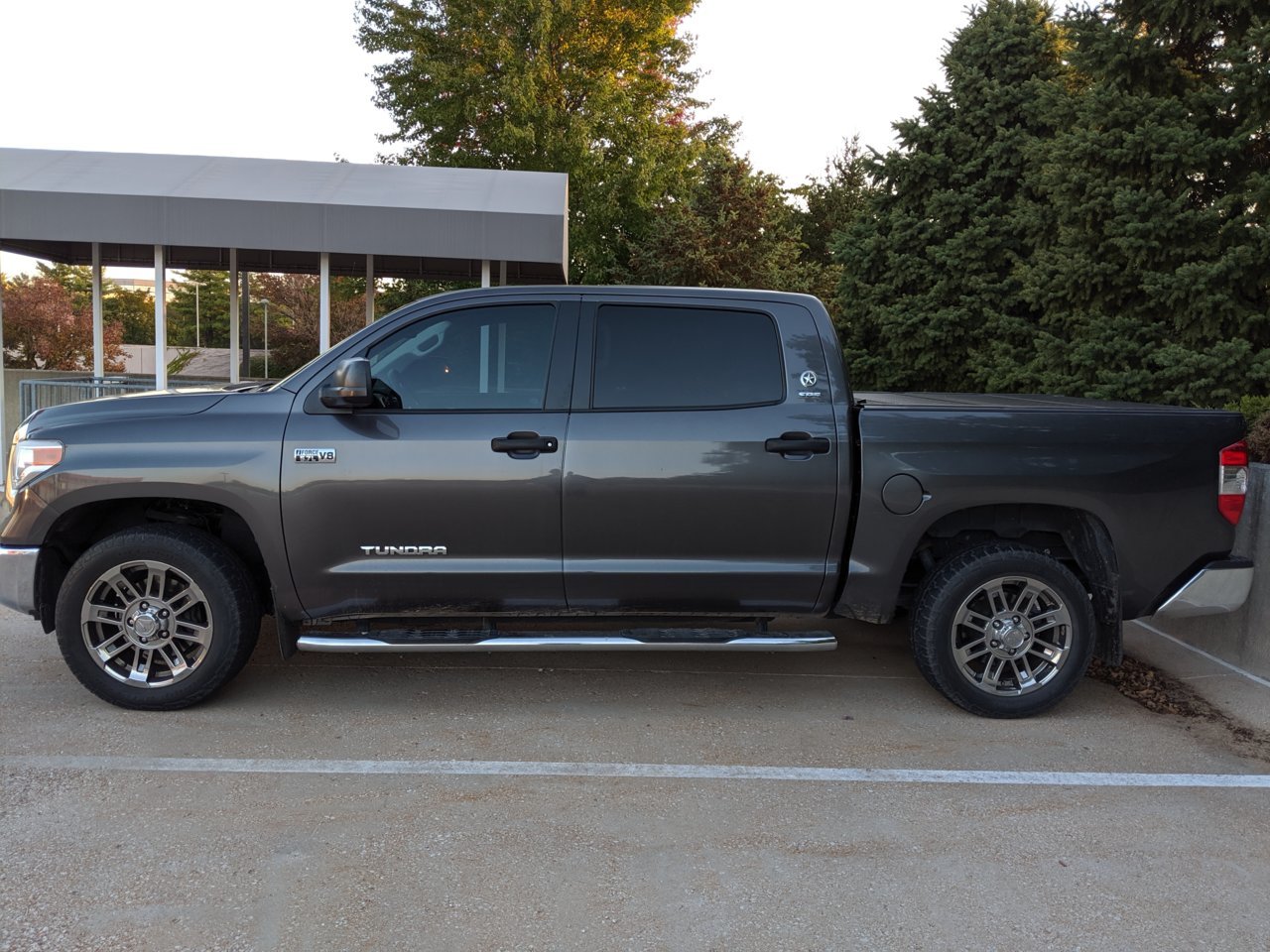

    Anyone have Method 309 Grid 18mm offset on their stock Tundra? Would like to see how far the wheels/tires stick out from the fender with 275/60R20 Falken Wildpeak A/T3 tires. Really want to make sure this is right before spending the money.

    This is a shot with Method 18" NVs (+25 offset) with 275/70/18s, so the 309's should stick out another 7mm.

    Awesome thanks! Thinking about dropping to 18s. 275/70/18 fit with no lift?

    It fits but it will rub the front and might rub the body mount lock to lock.
