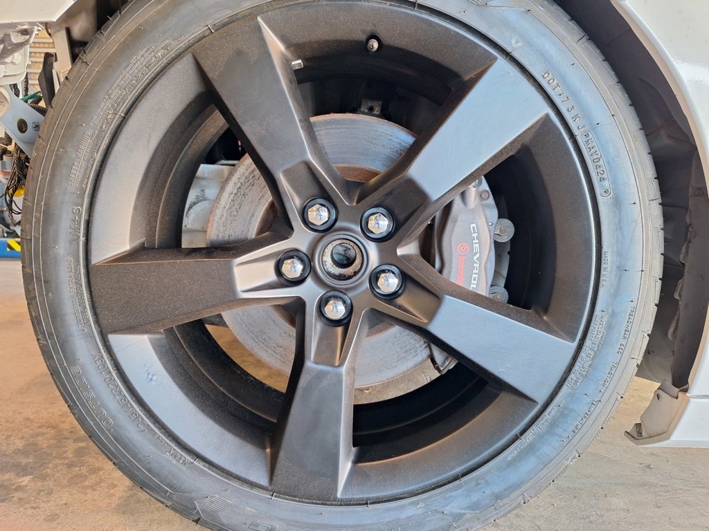

    lol those literally havn't been broken in yet on the car, pic of old brembo pads/rotors
    I Got the front clip off to reclear it and put my Oracle halo's on
    Terndrerrr[QUOTED] likes this.

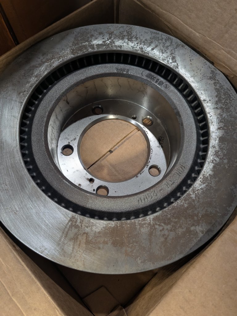

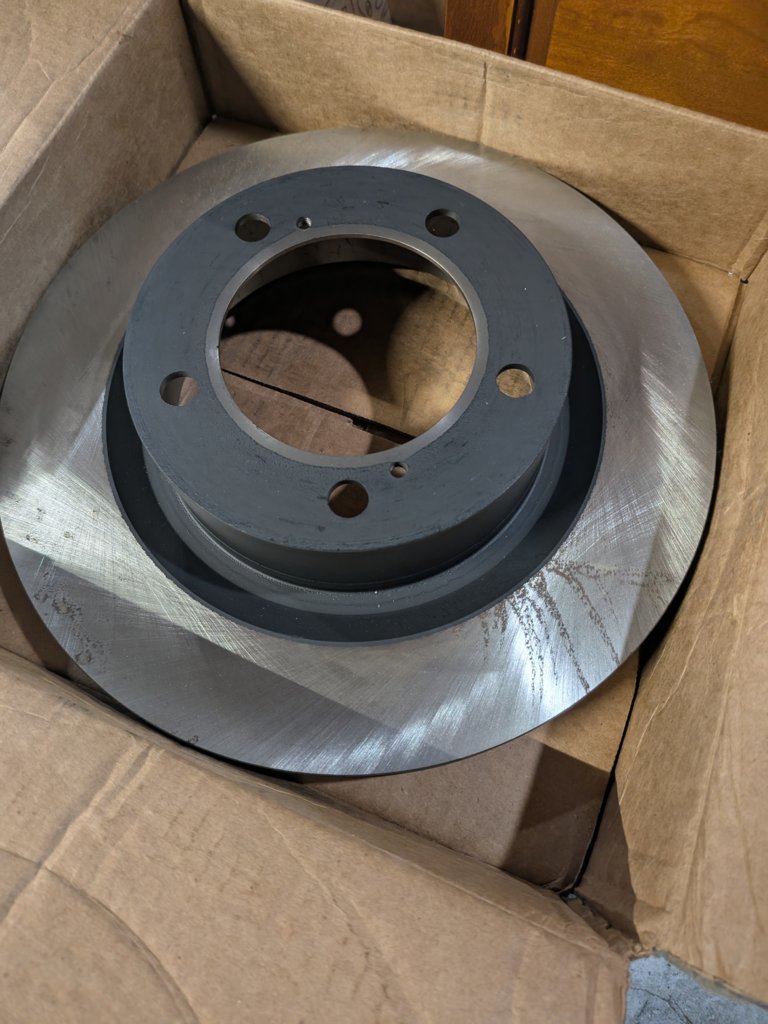

    I used to turn all my rotors (and drums) until I started getting newer vehicles. Now it seems that turning them is an outdated way to deal with warpage. That or the cost of replacements have significantly dropped so ppl just replace them.
    I have a new set of OEM rotors I'm about to install but there's a weird rust coating on one of them. Thinking I'll hit it with a die grinder disc before I slap it on.

    No coating of oil on them?
  23. Feb 16, 2025 at 3:51 PM
    texasrho83
    texasrho83 Old Member
    Mar 30, 2017
    #7025
    10,602
    Charles
    Conroe TX
    2016 DC MGM 4x4
    See build link
    Nope

    I just picked up new OEM rotors all around, none of them had an oil or other coating on them. I thought it was kind of odd.
    texasrho83[QUOTED] likes this.

    Yeah raw metal you'd think would have some sort of coating to keep from rusting.
    ATV25 and BeauDacious[QUOTED] like this.

    Just spray them with brake cleaner and wipe them down. Install and let the brake pads eat the rusties away. Unless they are obviously pitted.
