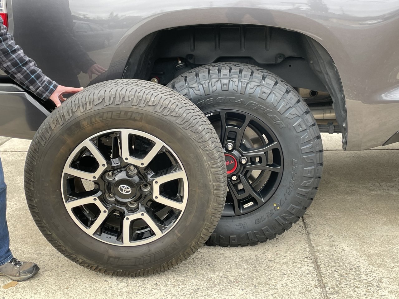

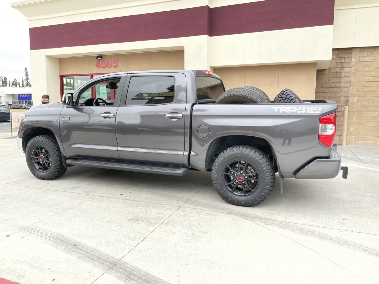

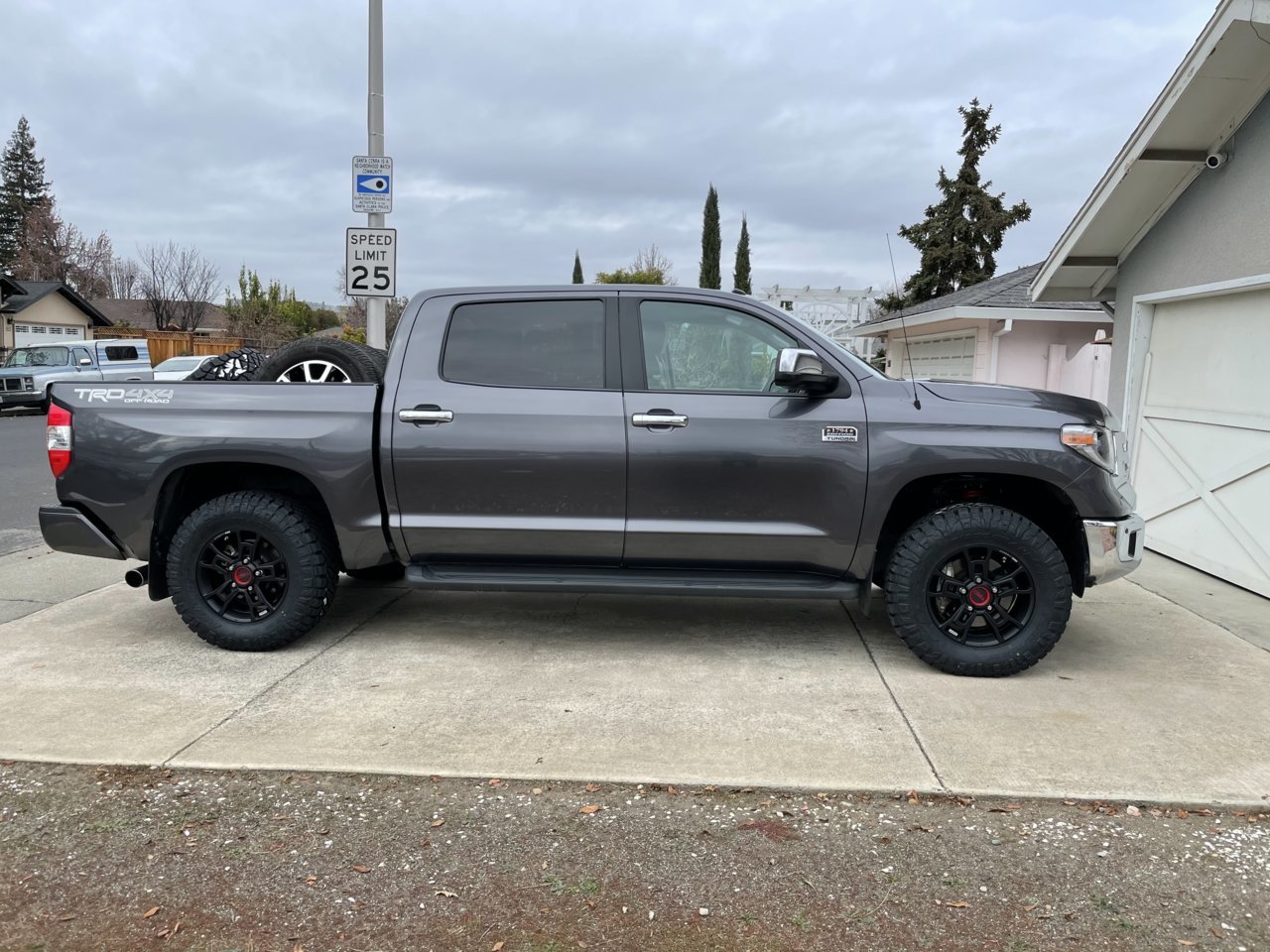

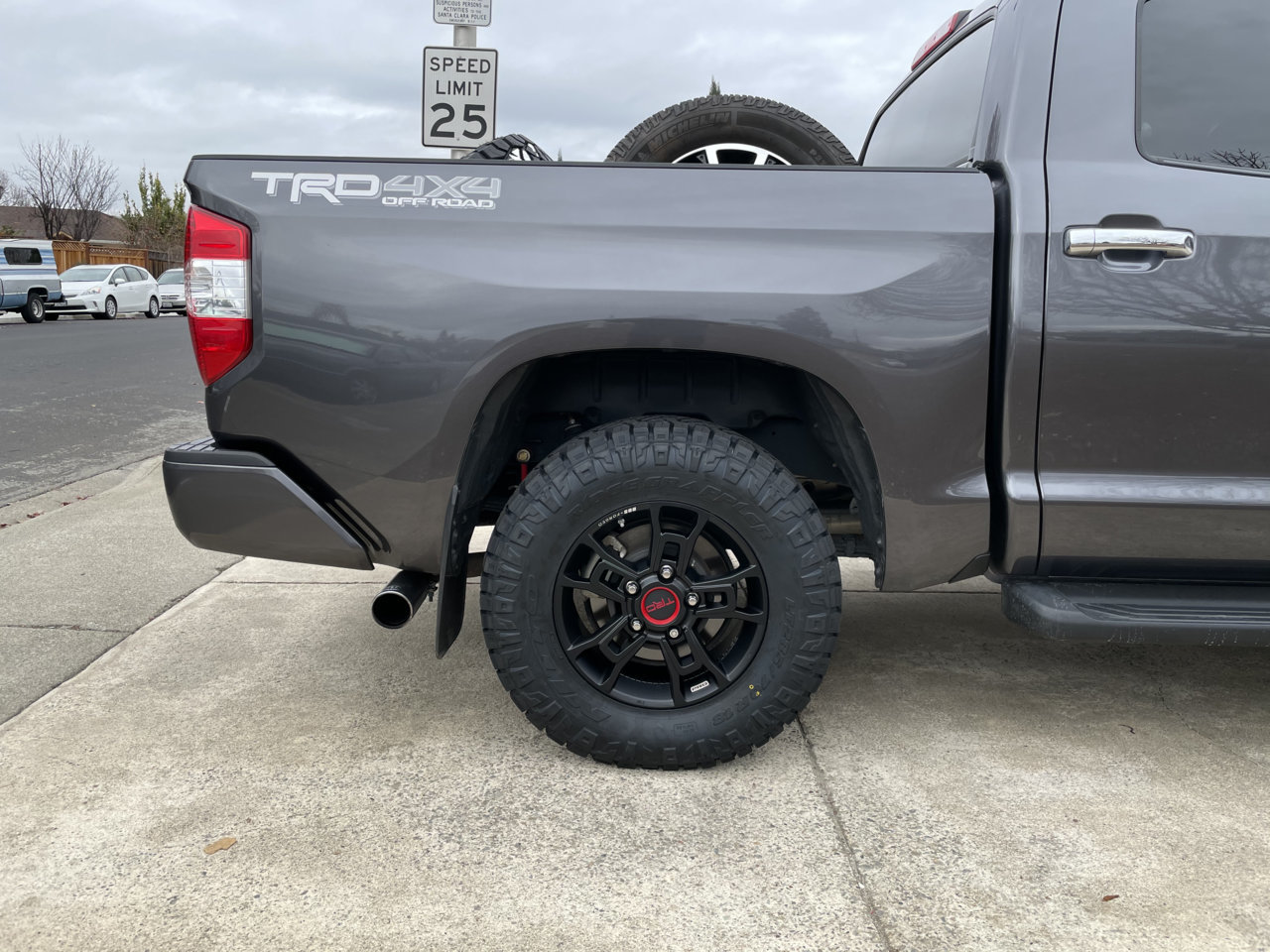

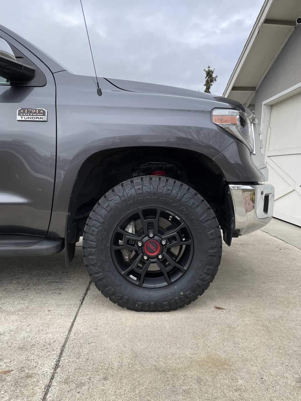

    285/70/18 on a 2018 1794 that has new 2019 TRD PRO FOX suspension and 2020 TRD PRO BBS Pro rims.
    I feel they fit perfectly, look good, gave about another inch in height, absolutely no rubbing, and I even left the little front air dams on. No issues.
    Rides great with that size and feels planted to the ground still.
    Hope this helps you in your decision.

    Looks great! Thank you. This helps a lot. Have you looked to see how close to front sway bar at full turn?

    I have not seen or felt any rubbing on the sway bar or anywhere Else.
    The offset on the factory rims seems to keep the tires in a more vertical position rather then flattened out.
    I have not aired the tires down for the sand yet, but Last I looked at the spacing I can’t remember being to worried about anything.
    I’m running 32PSI all around and have had no issues.

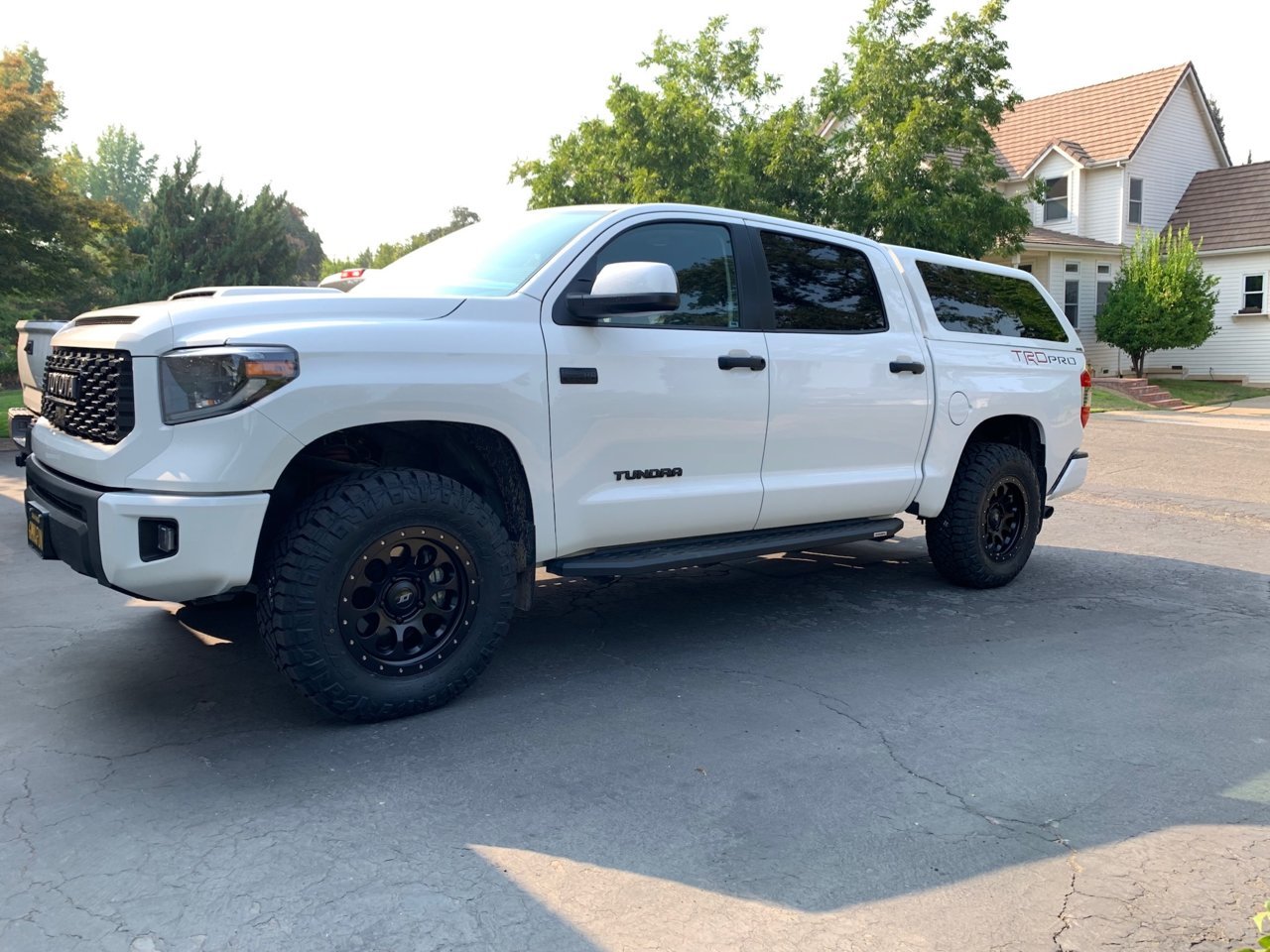

    No the offset of the stock wheels keeps them from rubbing. The SCS wheels are a +25 offset which changes everything, but also makes the stance look way better.

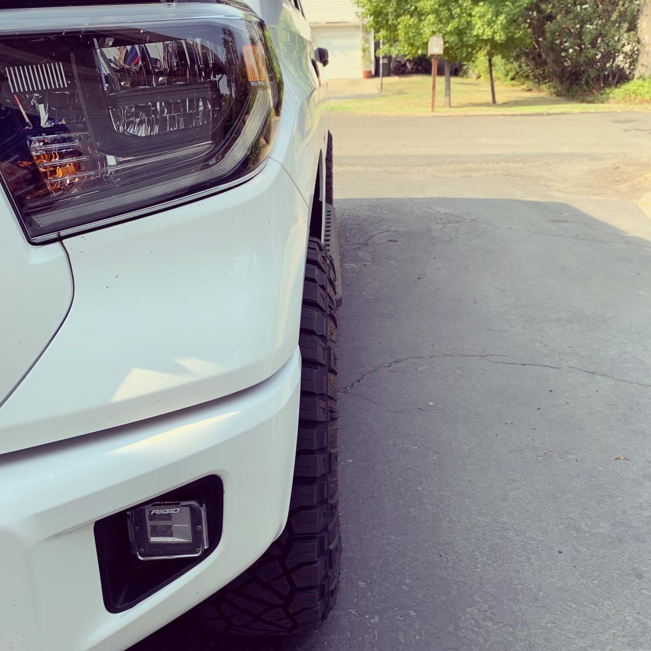

    Redhat you have any pics with your SCS wheels?

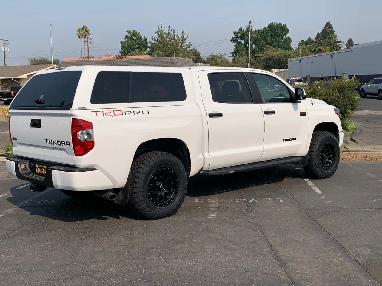

    Flush with fenders

    Side viewCFB14836-9EA5-4FE2-BB42-38B3CA513A45.jpgB7C4E2DE-ECC3-48CE-B83D-A8FED0917D25.jpg

    You running 275/70/18? Maybe I missed it some where.

    285/70/18 ridgegrapplers

    No issues with rubbing? I know it might be awhile till I get my hands on a set of SCS wheels. I have owned 3 sets now. None yet for the tundra. Waiting to get my truck this month. Deciding if I want to go 275 or 285. You truck look good!!

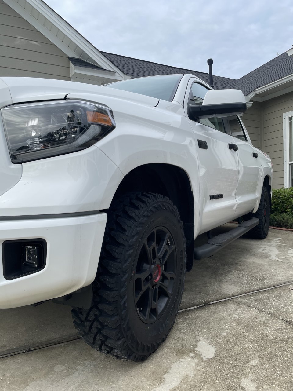

    New here, but have been an active “watcher” for the last year. I’m finally pulling the trigger and swapping out the Michelin’s for a set of 285/70/18 Yoko Geolandar MTs.
    ...speaking of which, if you’re in the market, simpletire has an absolute steal on them right now with a handful of promos (~1100 with installation).
    anyway, I purchased them then got a call from the installer.
    I’m now second guessing myself because the installer is hesitant because “he guarantees they will rub”.
    ..is this a typical warning shot from an installer...just in case?
    Again, I’ve researched like you for about a year and haven’t seen or heard of any issues...including mudflaps.
    *completely stock PRO

    It rubs where the mud flap was on the plastic that was behind it.

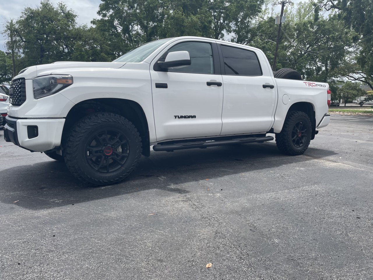

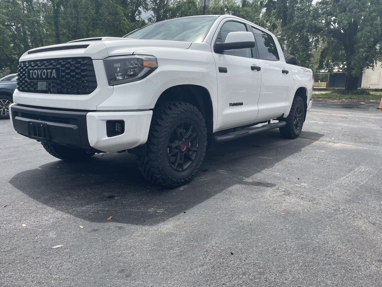

    Got them installed today...absolutely perfect. Might have slight rub on the small mud flap up front at full lock, but it's minimal if it does.

    Looks great.
    Like I said I think that size is perfect for stock factory offset rims.
    Trucks rides and handles great with that size. Plus you get about an inch+ lift.
    Enjoy your new shoes.
