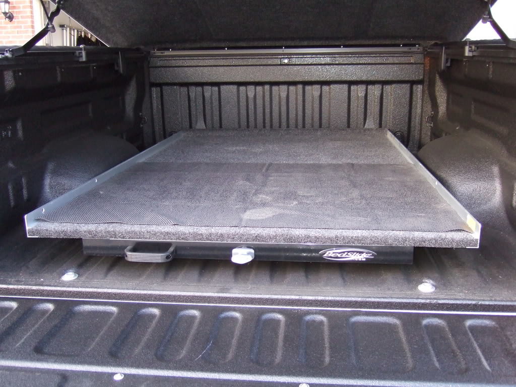

  30. Oct 26, 2018 at 12:05 PM
    #30
    TOTAL CHAOS
    TOTAL CHAOS WWW.CHAOSFAB.COM Vendor
    Jun 6, 2018
    #15939
    559
    Corona, CA
    Based on photos I've seen, there shouldn't be any interference. Our stiffeners don't stick very far into the bed area. You can install them and have full use of the bed slide.
    Here you can see the two bed bolts exposed. Our stiffeners attach directly to them and maintain a low profile.
