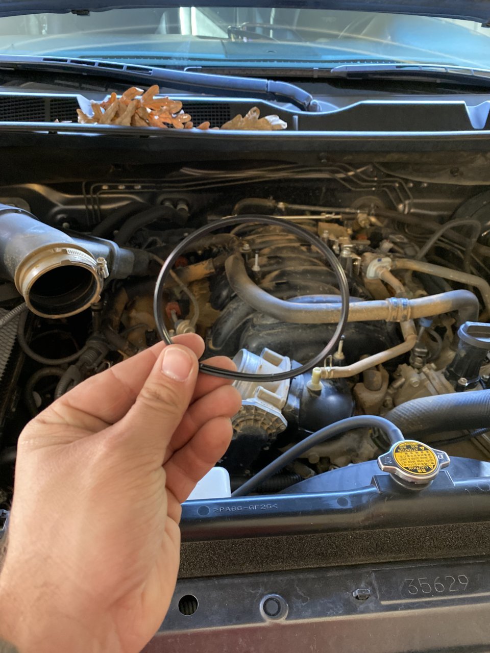

    I have a ‘16 TRDpro and there is a whistling sound anytime the engine is between 1500rpm and 4000rpm. It is driving me crazy. It sounds like it is coming from the passenger side. Under the hood it sounds like it’s coming from the right side of the engine. I replaced the throttle body gasket that others on here have suggested but it didn’t help.
    Im now not 100% what the hell it is. It’s not the belt and the truck drives normal. But if this sound doesn’t go away...Im going to have to go to the dealership. I don’t want to have to to go to that damn place.

    How does the air filter look? Have you taken a look around the seal for the air box? Mine whistled brand new but replacing the screen o ring resolved it 100%.
    McTrilliams[OP] likes this.

    It only makes the whistling sound when the RPMs hit over 1500. If you are in park and rev the engine, you’ll hear it but also when just driving around. The truck drives normal and I replaced the throttle intake gasket from that mesh thing to a regular rubber gasket and that didn’t solve the issue.
