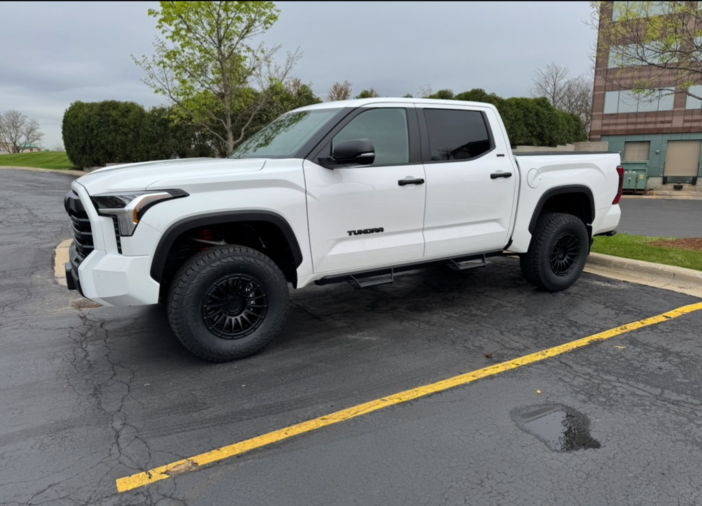

    I have 295/70/18 methods with +18 offset
    doesn’t sit flush but it sits perfect so the truck doesn’t rub at full lock.
    you do have to do the fender liner tuck tho and remove front mud flaps if you have them.
    I also have the factory 3” lift tho

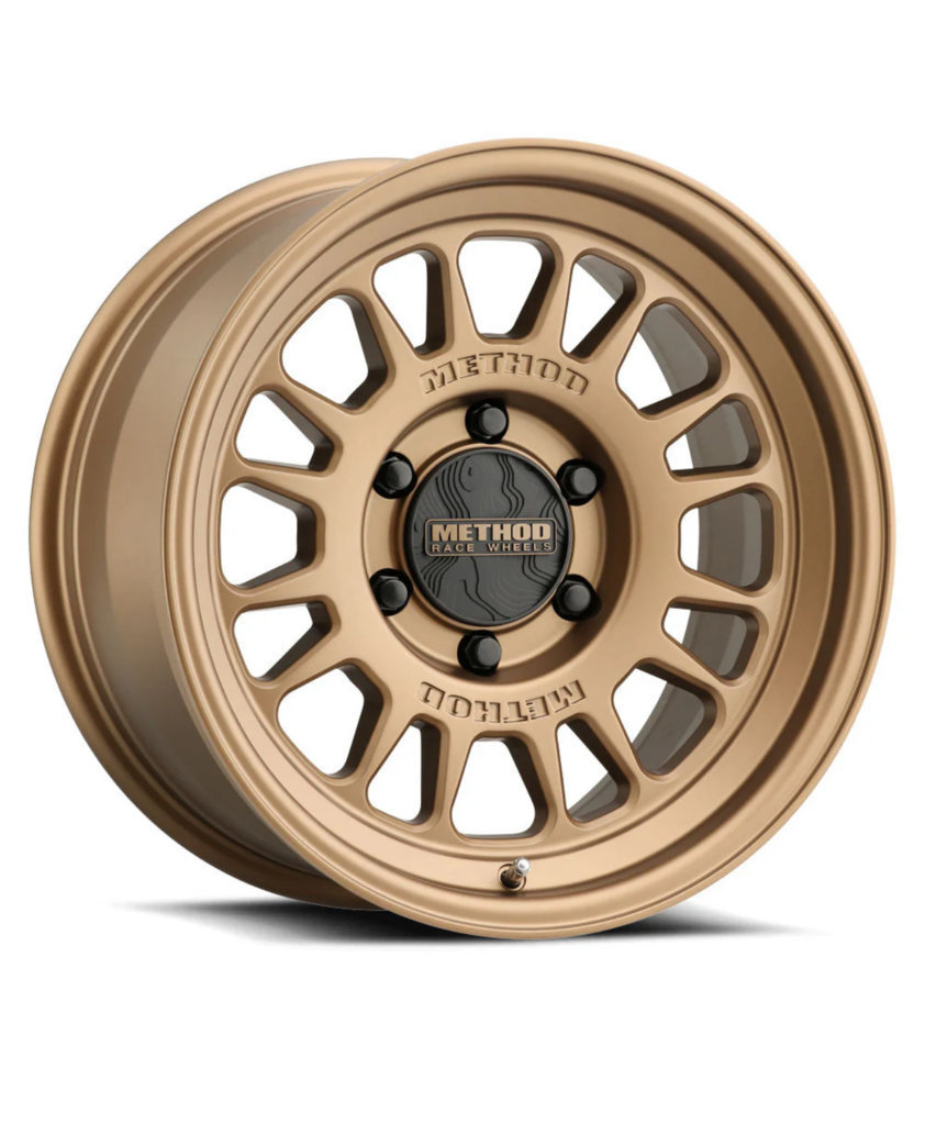

    Method 318 bronze with offset +18 wrap with Falken AT4W 295-70-R18. Will this fit 2025 Platinum non TRD stock truck with no modifications and sit flush with the fenders (no poking)?

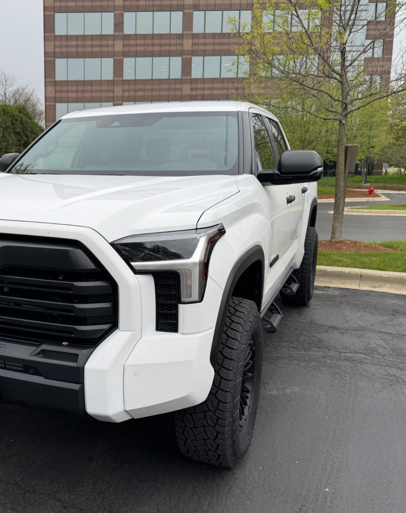

    No that is what I’m running 18x9 at +18 offset.
    that would look like mine with fender well poke.
    and idk if it’ll fit with no lift. Others would have to chime in for that. Just showing you the poke and stance
