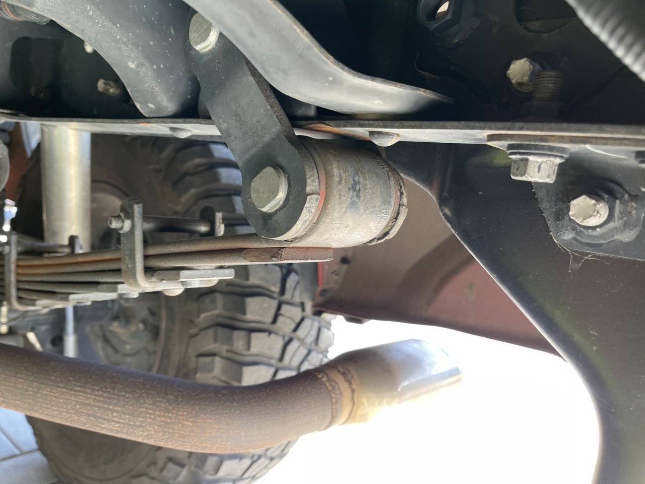

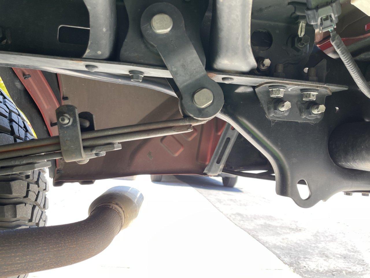

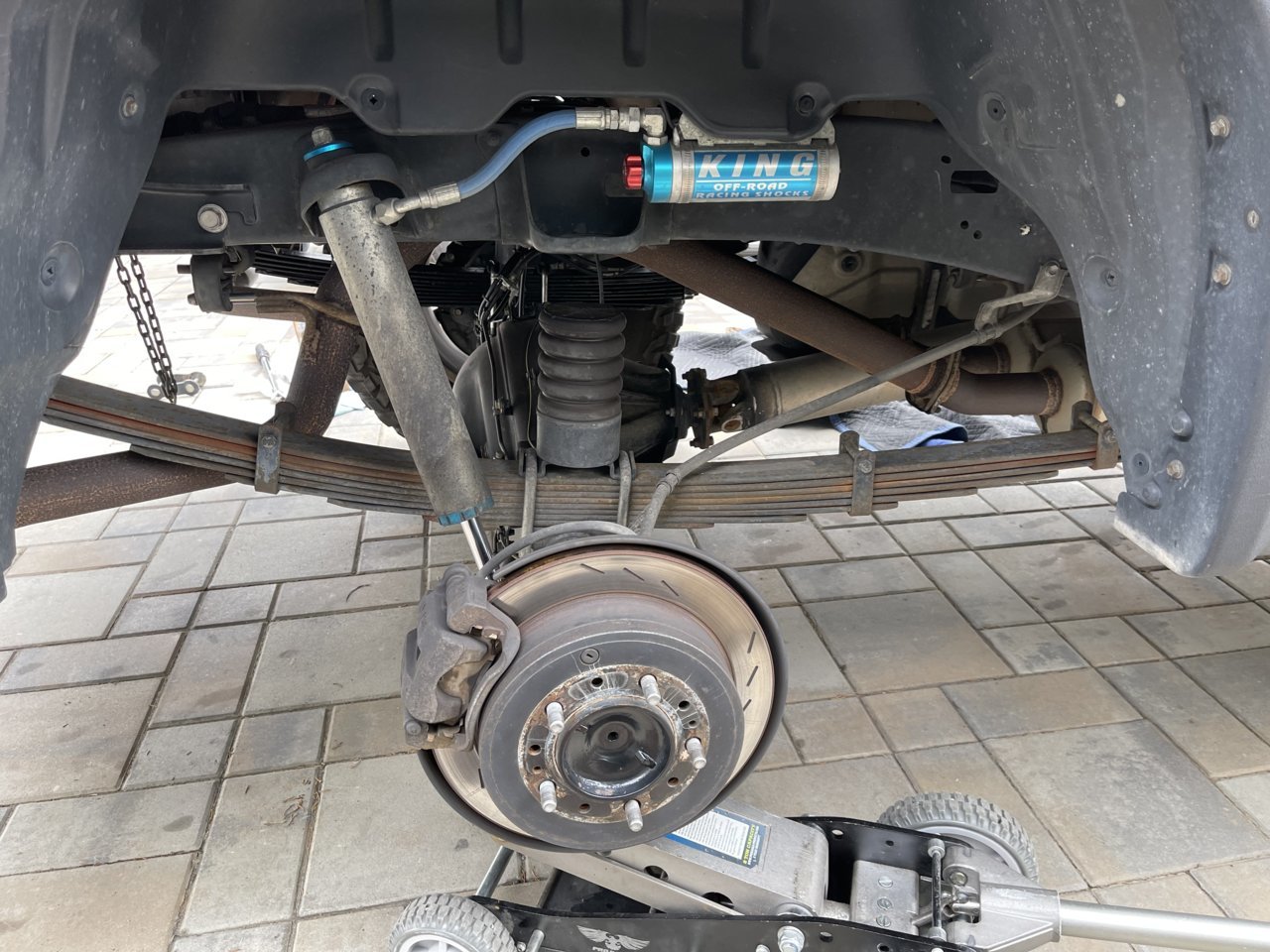

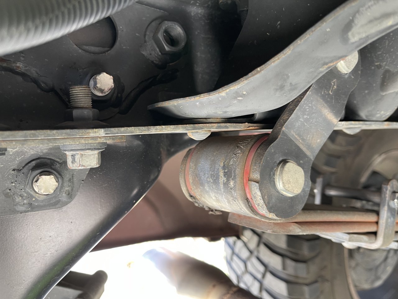

    On a different note. I got my TC shackles in. They look like they are about and inch or so longer than the stock shackles. My custom alcans were made to provide 2” of lift. They are flat at the moment and I’m assuming it’s my fault for running them with the stock shackle which was a bad idea. The shackles hit my frame and caused a little bit of damage. Now for the question, can I use the TC shackles with those alcans till I get my deavers in a month or so without damaging my king Oem ext shocks? The lift would be like 3” or so after and I don’t think the shocks can handle more than 2” lift. Here is what happened on both sides. 5C024B4B-E5F5-4AF6-8120-FF31690E7B43.jpg52D6C711-14BF-4AAE-AD54-56630D0EBDF7.jpg8CBED92D-FE13-495F-8E8D-DED1A58DDA52.jpg86F50E49-5912-4245-842C-4BCBCF8D3691.jpg

    I don’t think it would put you at 3” if your existing shackles are angled like that with alcans. If anything the TC shackles look like they would give you some “breathing room” for your current leafs and would also be angled without rubbing on the frame.

    This is why I was asking. I don’t drive the tundra right now cause of what it’s doing to my frame. I didn’t know that when you go with aftermarket leafs for lift that you should be using aftermarket shackles.

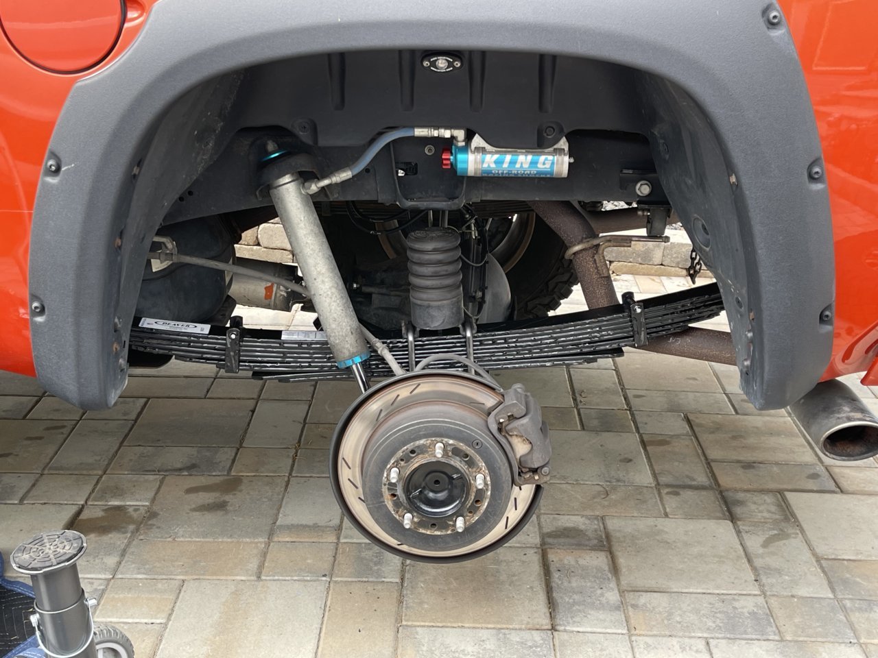

    Got my deavers in and about to install them, but I don’t know which side is what? Nothing on them that says drivers side or passenger side. There are only two stickers on them. One has an R at the end of the number which I would assume is the right leaf, but I could be wrong. Anyone know which one of these are the drivers side and passenger side? 7E0E2150-0AE6-4840-B93A-FC20AEA1A054.jpg C0532323-8396-4A7C-B6F8-EA6B2B6DF1D2.jpg

    According to this post the double wrapped eyelet goes toward the front. This guy initially put them on backwards. https://www.tundras.com/threads/deaver-k37-vs-u748-pros-and-cons.18008/page-9#post-1929527

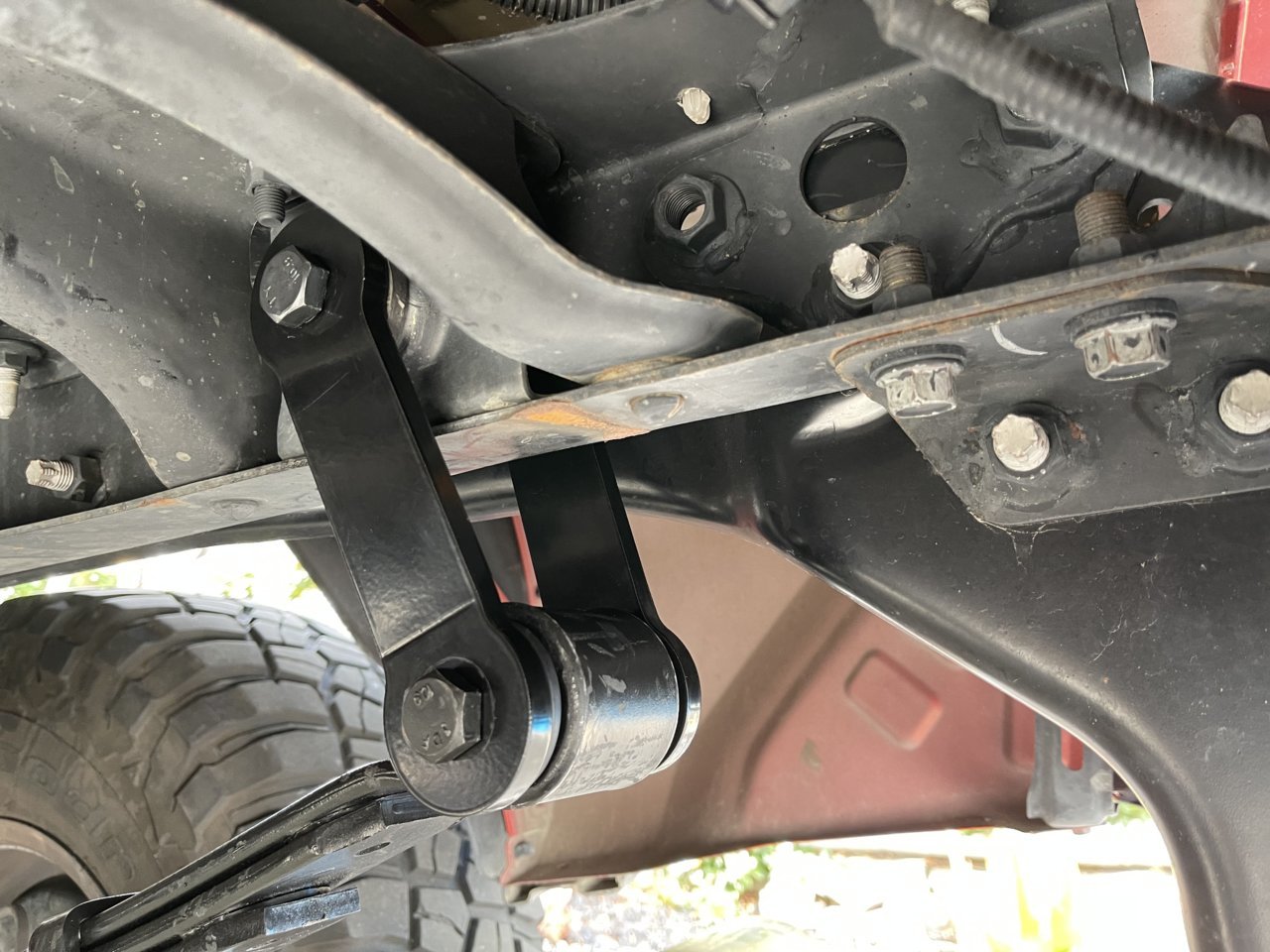

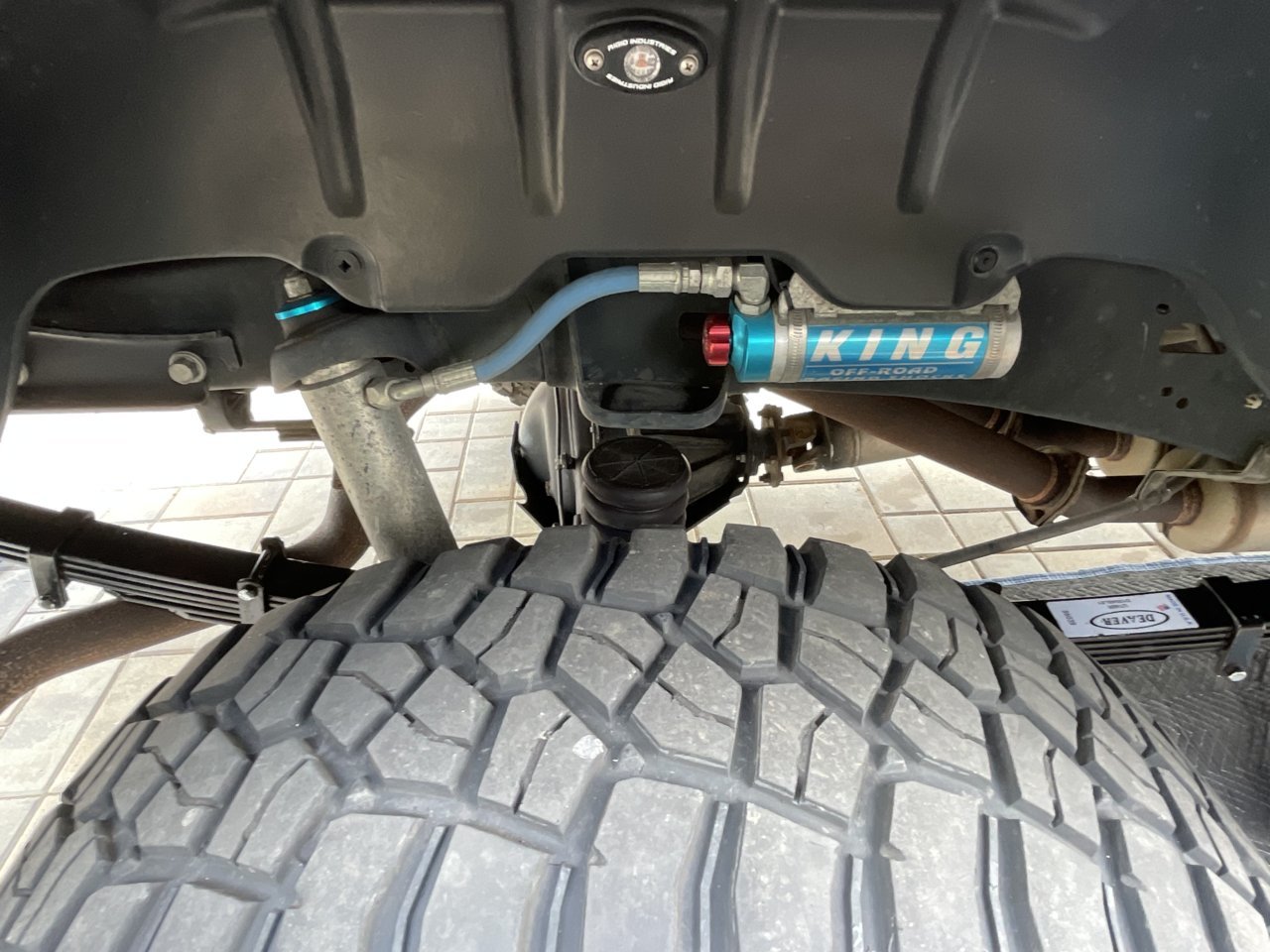

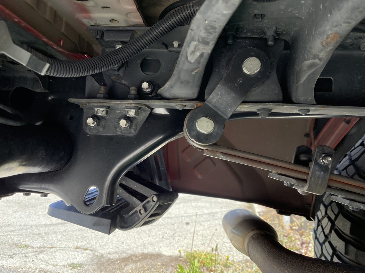

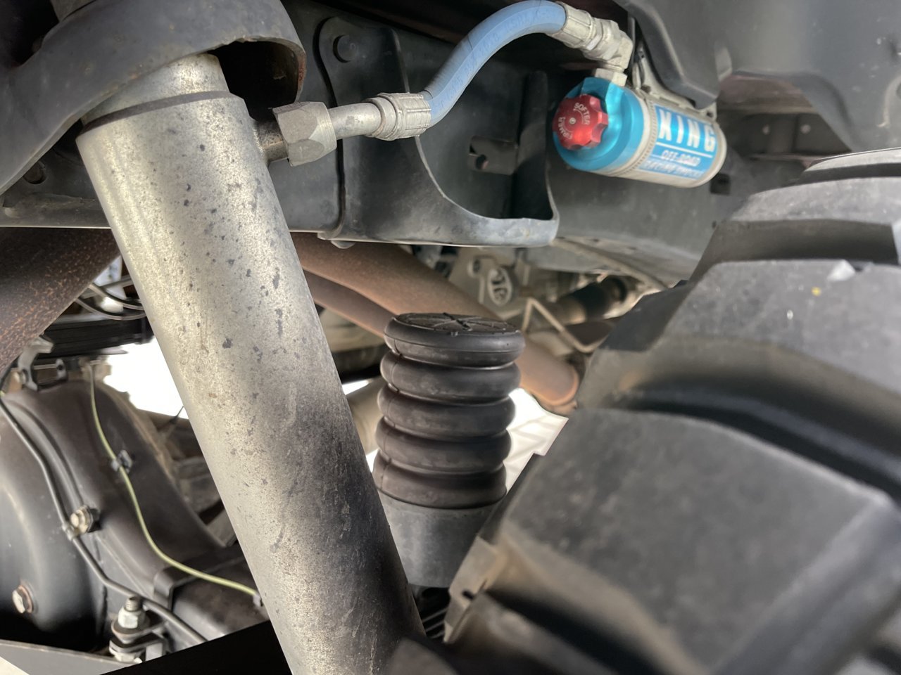

    Thanks. I finished installing them and the total chaos shackles. Now the truck doesn’t sit on the timbrens and the shackles/leaf no longer rest on the frame. You can see where the leaf was hitting my frame and dented it. D32A08C9-25CE-408C-AC01-5283B72F8254.jpg7CD915C2-BBC8-4441-922B-56A6D32C752D.jpg29444D6B-BB72-4387-8FE7-B29290AE893B.jpg3165B268-06ED-42E4-8F70-A7A3C658D455.jpgF71E5E28-90B3-427B-9B62-E6D86A980C06.jpg

    Nice. Did you get the two inches advertised with the TC shackles?

    949
    Bay Area, California
    2015 toyota tundra trd pro
    I would say so. I’ll measure tomorrow. What I do know is that nothing is touching and my suspension has room to travel again. So I’m happy. The truck looks better now too. I’ll take a picture of it tomorrow for a before and after.
