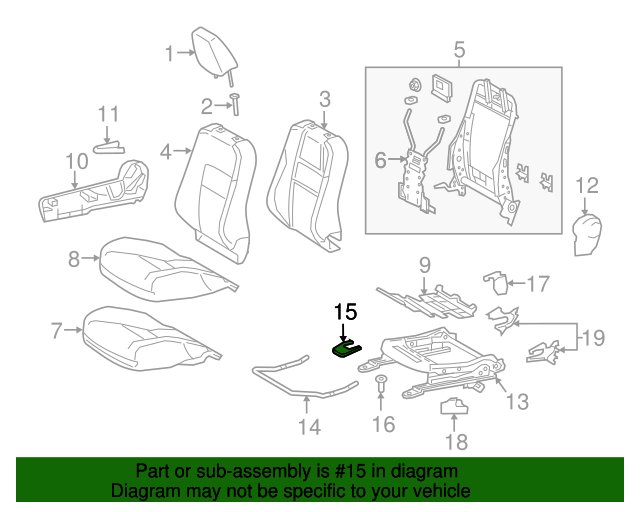

    I stopped to get gas and noticed this piece sitting on the driver side floor. Must've bumped it. The question is, where does it go?

    did the ol google search for that part number and this is what came up. Look like it goes on the end of the seat track

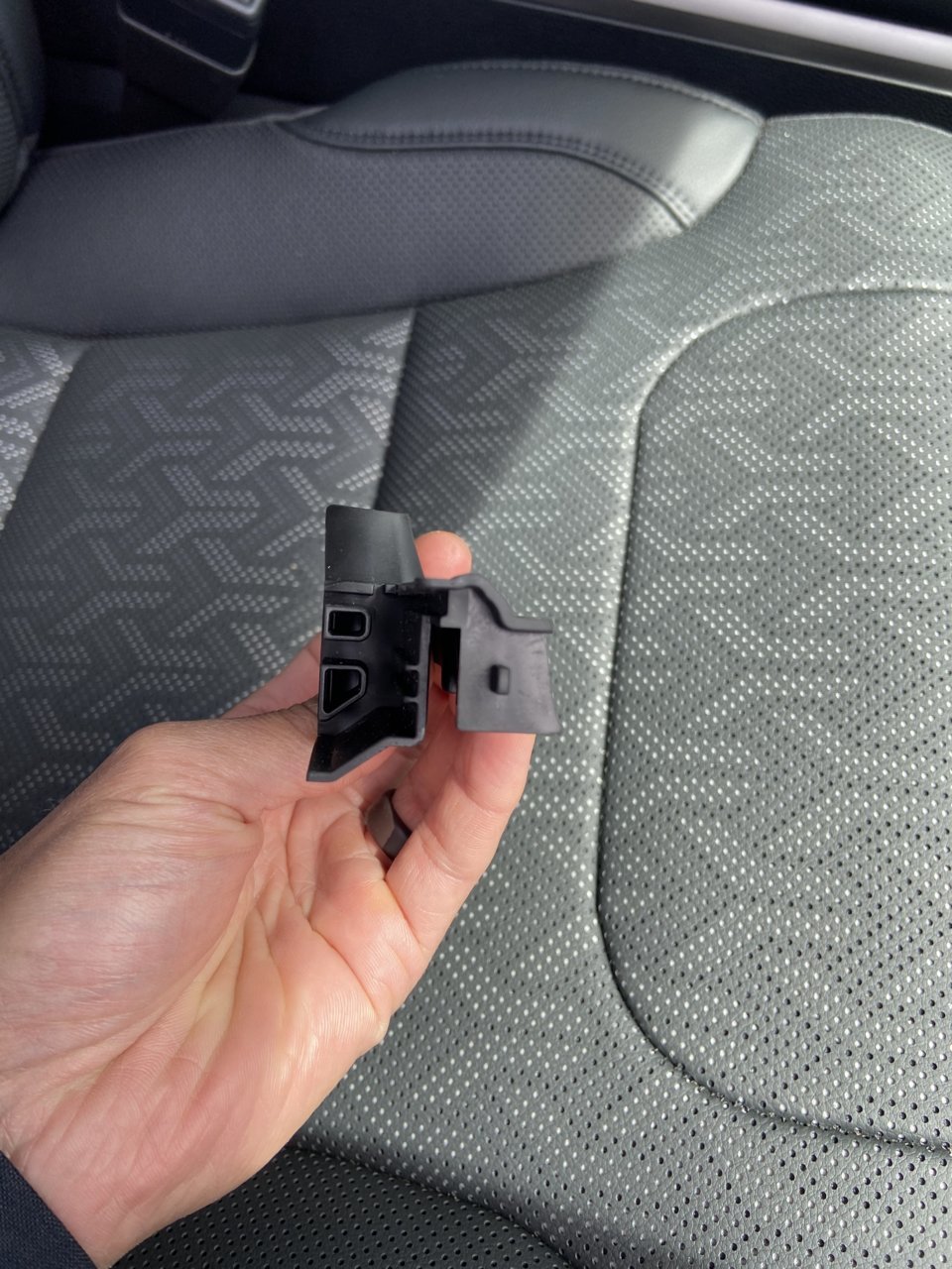

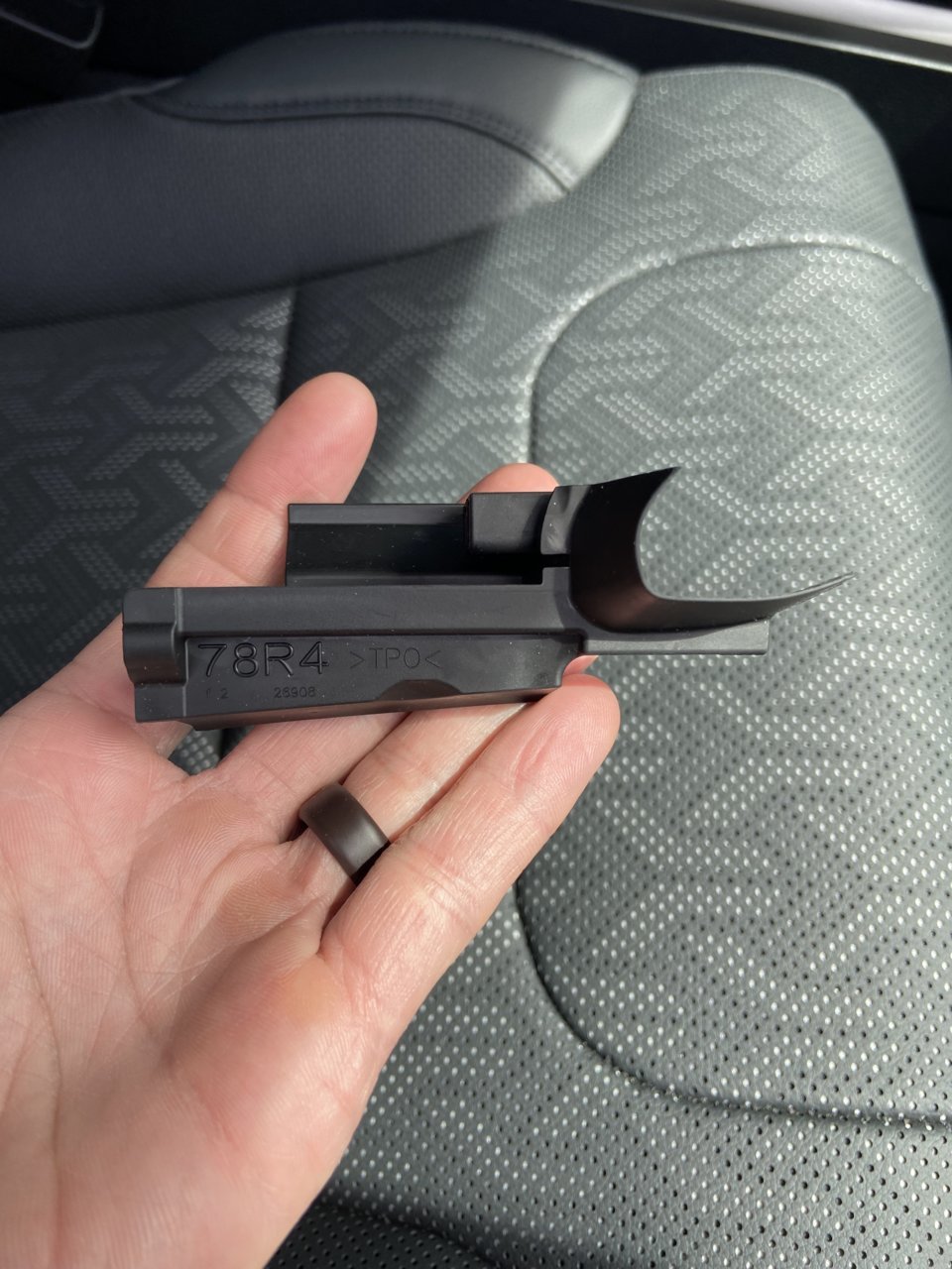

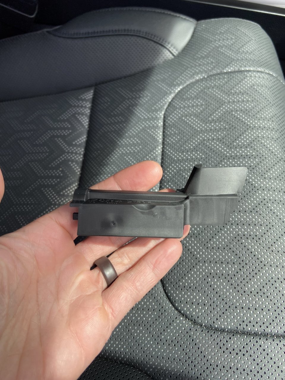

    Ok, my turn...
    What part of my truck is this? Found on passenger side floor days after taking the truck home.

    do you have a part number for that mentioned? or a picture of where it goes?

    Did you find where this piece goes? I found this same part on my floor boards, can't find where it fits under the seat. Googled the P/N, no results.

    I thought the same thing but haven't found a spot for it. It's rubber rather than plastic too which is a little unusual for a wire cover, I'd expect that to be cheaper hard plastic.
    No luck finding a place for it and also no luck searching that part online. Funny you found the same one! Maybe it's the source of the horrendous wind noise on that side of my truck LOL.

    I just found where that piece goes. It attaches to the window trim at the rear corner of the front side windows.
    The one in your hand is the passenger side. Look at the driver side window in the back corner and you can see the top of the rubber trim around the frame.
    You have to remove the door panel to reinstall the trim piece

    Yep that’s what it is. You beat me to it. The seal/belt molding on the inside of the front driver/passenger windows are 3 piece. The central belt mounding section and 2 end caps that form fit around the door itself. You can’t see the front one as it’s behind the panel that covers where the mirror is.
