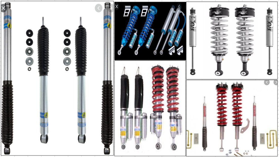

    One of the most asked about questions. "Which suspension systems do I get?" I have a two wheel drive pavement princess that will never see off-road conditions. If I can help it, it will always be on some kind of paved surface. I bought the truck knowing this was going to be my intention from the start. The only suspension modification that I have done to the truck is put front and rear TRD sway bars on it. I like the better handling feel going around corners due to the added sway bars. Even before installing the sway bars I knew a suspension upgrade would be in the future, I just had no clue which one. Well, I still have no clue which one. Here is my criteria/wants I would like to address when upgrading the suspension.
    1. I like the fact that my truck fits in my garage, height wise, so I am not looking for this giant 8" lift to raise the truck up. If possible keeping the truck at stock height would be desirable or as minimal of a raise as possible is also OK.
    2. Better and improved ride quality. I'd like the suspension to better handle bumps, potholes, and railroad crossings. What I mean by that is, I would like the travel over these types of obstacles in the road to not be as harsh/jittery in the cab.
    3. Not sure if this one is possible but I would like the suspension to compliment and be compatible with the TRD sway bars. I enjoy the more confident feel going around corners but also want better ride quality in straight lines.
    4. I don't want to spend a ton of money. I realize it sounds like I want my cake and I want to eat it too, but maybe for those who are more well versed in suspension, can point me in the right direction that generally meets the "wants" I have listed while not breaking the bank.
    Thanks to those in advance who can provide some guidance.

    for a pavement princess.....i'd say Bilstein. gonna be a similar ride quality (maybe a bit better). Oem quality and the 5100's are cheap.
    If you want a bit beefier front shock, you could go with the 6112's. I like mine.

    As mentioned, the Bilstein setup will be the cheapest. It will ride better and you can level it out. I went with the Toytec Alumas on mine.

    I bought the 6112 assembled at 1.9" lift (it prefectly leveled the front) from Boss4x4 for $700. I'm still running the stock rears. I'll eventually get 5160's for the rear.
    You can put 5100's on all 4's...they cheap

    I did 5100’s as a stock replacement(bottom clip). It for damn sure rides no better than stock.
    It’s not worse but definitely no better. Not meaning to complain, i didnt expect anything other than to look better and replace the 150k mile stockers. But if your looking for a noticeable improvement, gonna have to step up a notch.

    Given your intended use I would just go with the Bilstein 6112 setup. The ride is noticeably better than stock and they are inexpensive.
    If you can find some TRD Pro take offs at a good price that’s an option also.

    I’ve got the 6112/5160 combo, they ride a little stiffer than stock, more truck like IMO. For a street rig they feel more planted than stock, when you come to a dip or rr tracks that would normally make you cringe, they just soak it up like nothing. I like them a lot so far, have about 20k miles with them. Happy with them off road too.

    I was debating between the OME, Bilstein 6112/5160 but ultimately went with Toytec primarily because I didn't want to dick around with shims an I really wanted 3" up front. I wanted the height adjustability to dial in what I wanted. An frankly I feel Toytec invests more in Toyota specific development then the others.. Plus I went with Aluma series because I live in winter salt wonderland an the Aluminium body will holdup much better in my environment. Its a good quality product. At a lower price point than fox or king.. However given your not looking for height an or off road improvement I'd probably lean at Bilstein on a low setting.

    So it seems the vast majority are suggesting, for my needs, the Bilstein set up. This is very helpful and I appreciate the recommendation. Now that I have narrowed down the brand, how do I know which version of Bilsteins to get for the front and rear to achieve what I am trying to do? I have seen some comment that if I were to go with the 5100s all the way around, I would not notice a difference from stock suspension. Would most agree on that? If so, for those that know or who have had the Bilstein set-up, what would you recommend for my original post criteria???

    Agree with this. For your purposes, 6112's on the front and 5160's on the rear are as good of a road ride you will get for what you want to spend.

    ToyTec Boss for me.. I off-road a lot. But it definitely is a far better ride on bumpy shitty paved roads. Adjustable Without disassembly to correct the “lean” and desired height.
