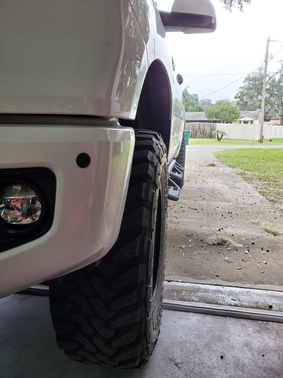

    You looking for something like this? This is a +0 offset.

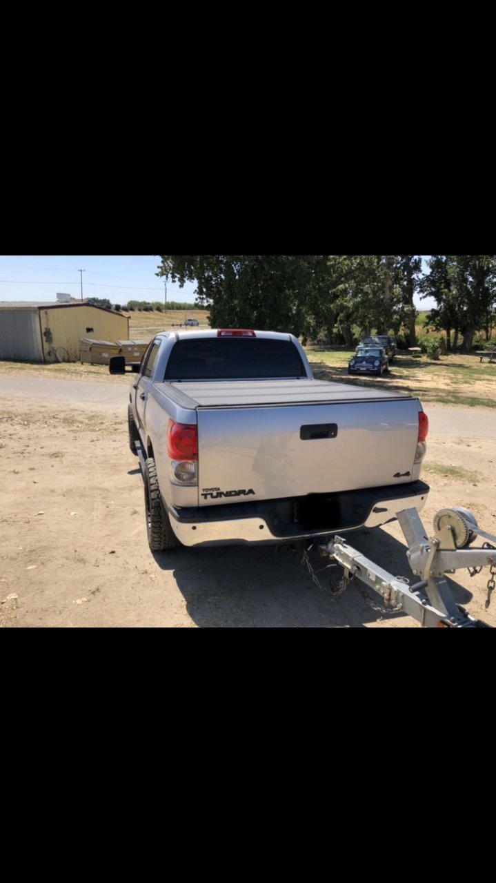

    Borla exhaust, Alpine Halo 9 head unit, Oracle Colorshift rock lights, 3in lift on 17in Fuel bead locks, Paragon bed cover, Recon lights...TBC

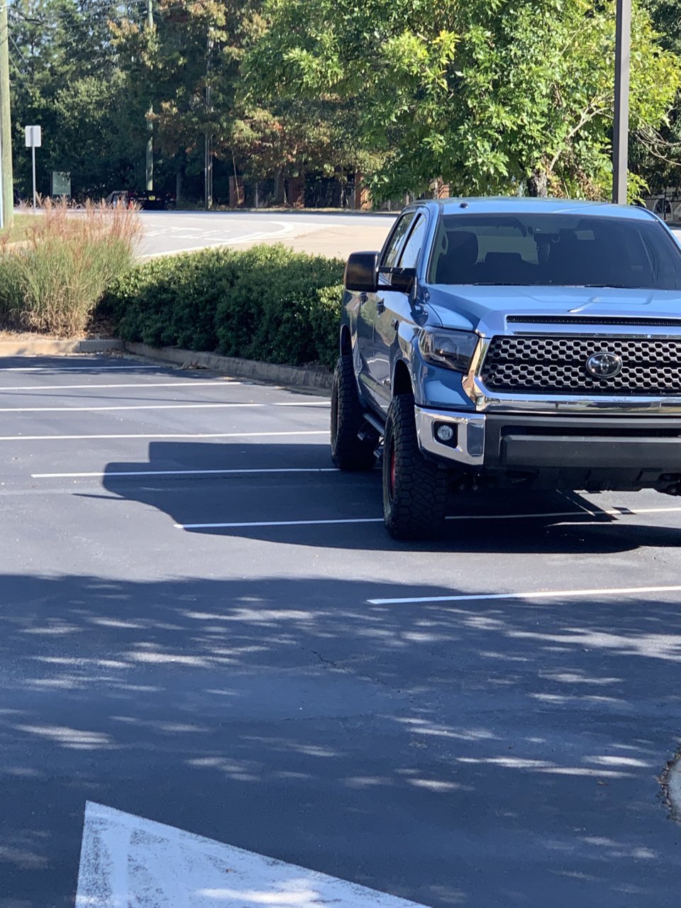

    295/70 on +25 offset

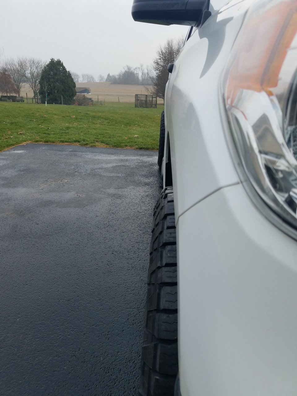

    275/70R18 Cooper AT3 XLT on SCS SR8 18x9" +2520201212_151201.jpg
