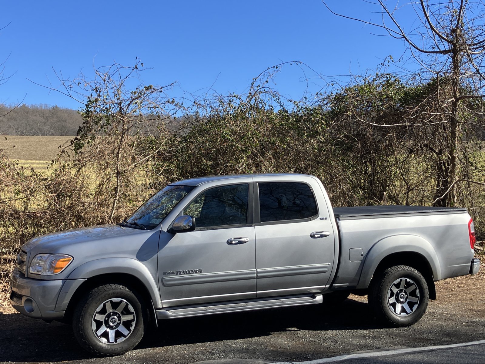

    will these 17” 4Runner rims fit my DC directly? Truck is stock (not lifted) do I need to add anything? Spacers? Etc?

    Yes, the will fit

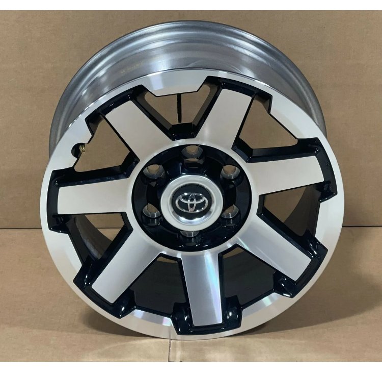

    Thanks Frenchy and Gipsy for the pic. I almost bought a set of those yesterday for $400 but hesitated and someone beat me to them. On the hunt again.

    I found a set that were just taken off a 2023 4Runner. Do the air pressure monitors come with the rims or do I need to buy them separately? How do they sync with my truck? Will the monitor system pick them up?

    The TPMS sensors are mounted where the valve stem goes, so if the rims have tires, they should have TPMS sensors. It's pretty clear whether the wheels are using a standard valve stem; TPMS stems typically have metal showing outside the wheel.
    Not sure if the ones off the newer T4R wheels will be compatible.
    You need to program the sensors into the TPMS system for the Tundra, if it's possible. You'll need a TPMS tool (handheld) to scan the wireless ID on each sensor, then program that ID into your truck. OR to have the shop program the existing IDs in your TPMS ECU onto the sensors in the wheels.

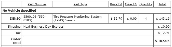

    Yes. If the light is solid, it means your tire is low. If the light is flashing, it is normally a communications error, like... the battery inside the sensor (which is almost impossible to replace) finally died.
    Best bet? Replace the existing sensors with new Denso sensors that are the correct model for your truck. You can look up the correct part number at www.densoautoparts.com
    I just replaced all 4 of mine; $30/sensor buying at RockAuto, which had cheaper prices than I could find anywhere, including Summit and scAmazon.
    Yes, this is expensive, but authentic Denso sensors are good for 15-20 years if you buy quality OEM ones. If you choose to get the generic ones ... let's just say there are a lot of guys on here who got frustrated and pulled the TPMS lightbulb from the dash because they got tired of seeing the light come on, even with the new sensors. I remember one guy went back to his tire store 4 times (because in the '05-'06 you can't remove the light bulb :rofl: ) and they still couldn't get the popular aftermarket brand to work.

    Please send me the Denso part number if you have it handy. I tried to find it using the link you sent and got lost.

    550-0103
    Don't buy 'em on scAmazon, you'll probably get knockoffs.

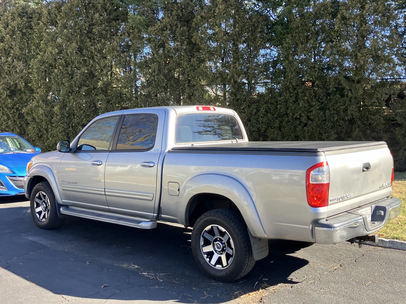

    End result. The tire pressure monitors were an odyssey but my guy sorted it out.

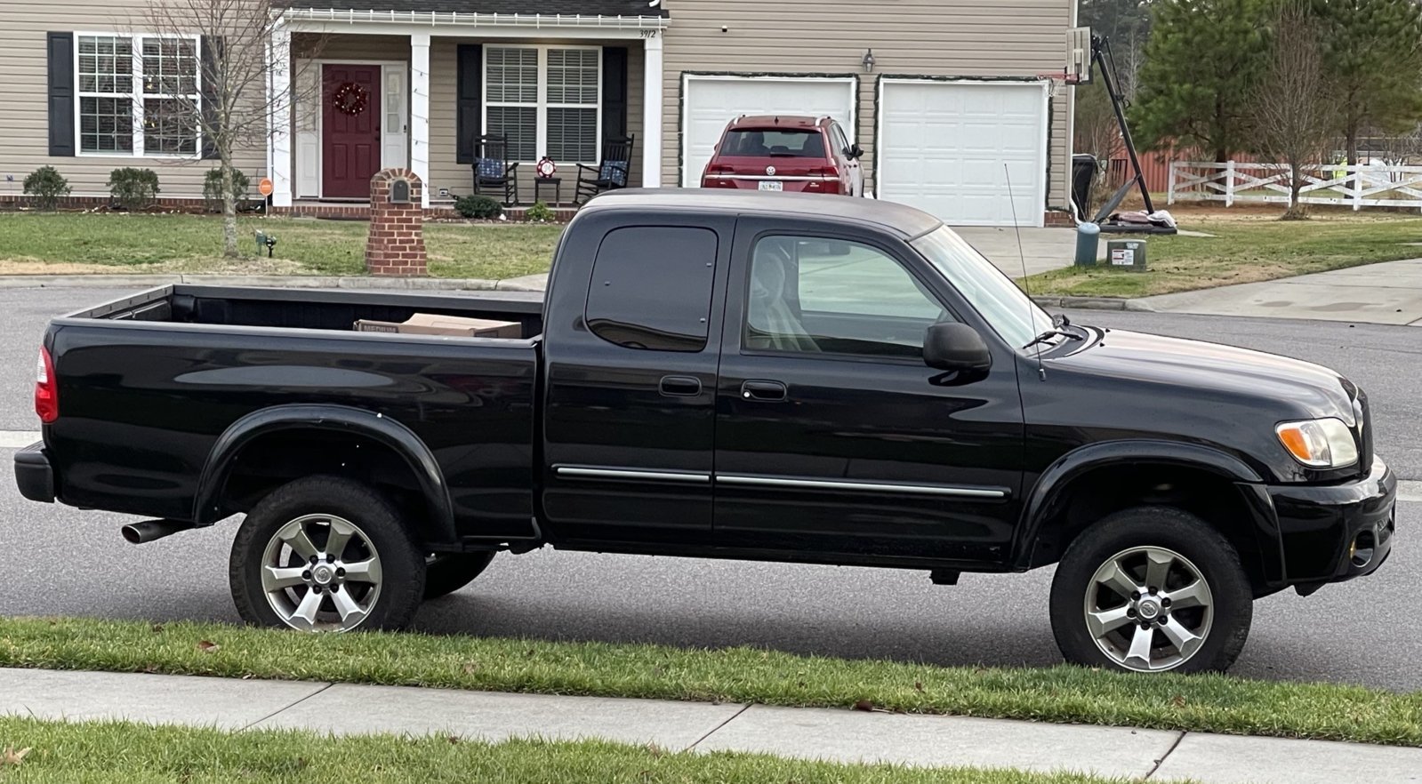

    I agree. I did the 07 Limited 4Runner wheels. I just need better tires. Just not sure what size, except going 275 or 285/70x18

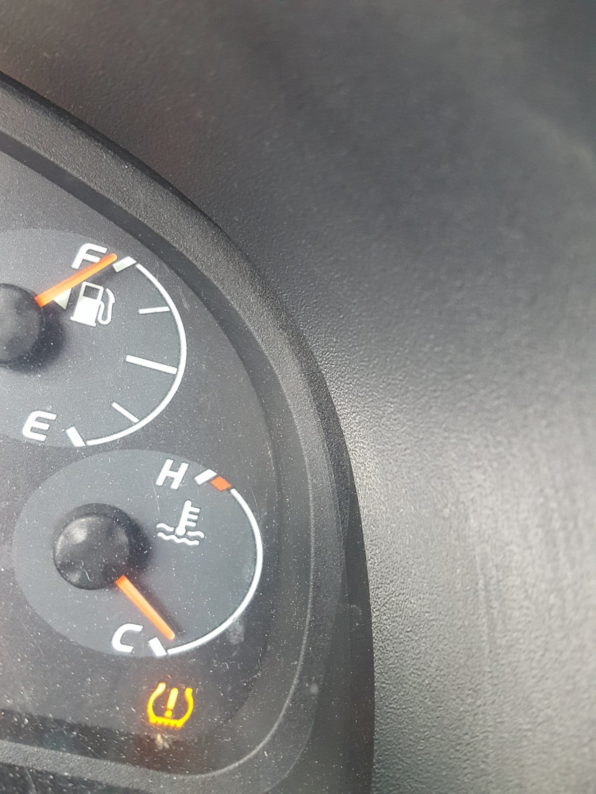

  26. Feb 7, 2024 at 9:03 AM
    #26
    Canada SR5
    Canada SR5 New Member
    Jan 31, 2024
    #111236
    52
    Lukas
    06' 4.7L AC 4x4 and 08' 4.7L DC RWD
    20240207_113645.jpg This little light of mine, i am gonna let it shine.

    If it's flashing, I got mine to go away and not come back in about 3 minutes using an OBD dongle. If it's solid, you just need air in your tires.

    No sensors, light flashes. I don't even notice the light anymore lol

    Mine is solid and doesn’t need air. I don’t have sensors in the wheels.
