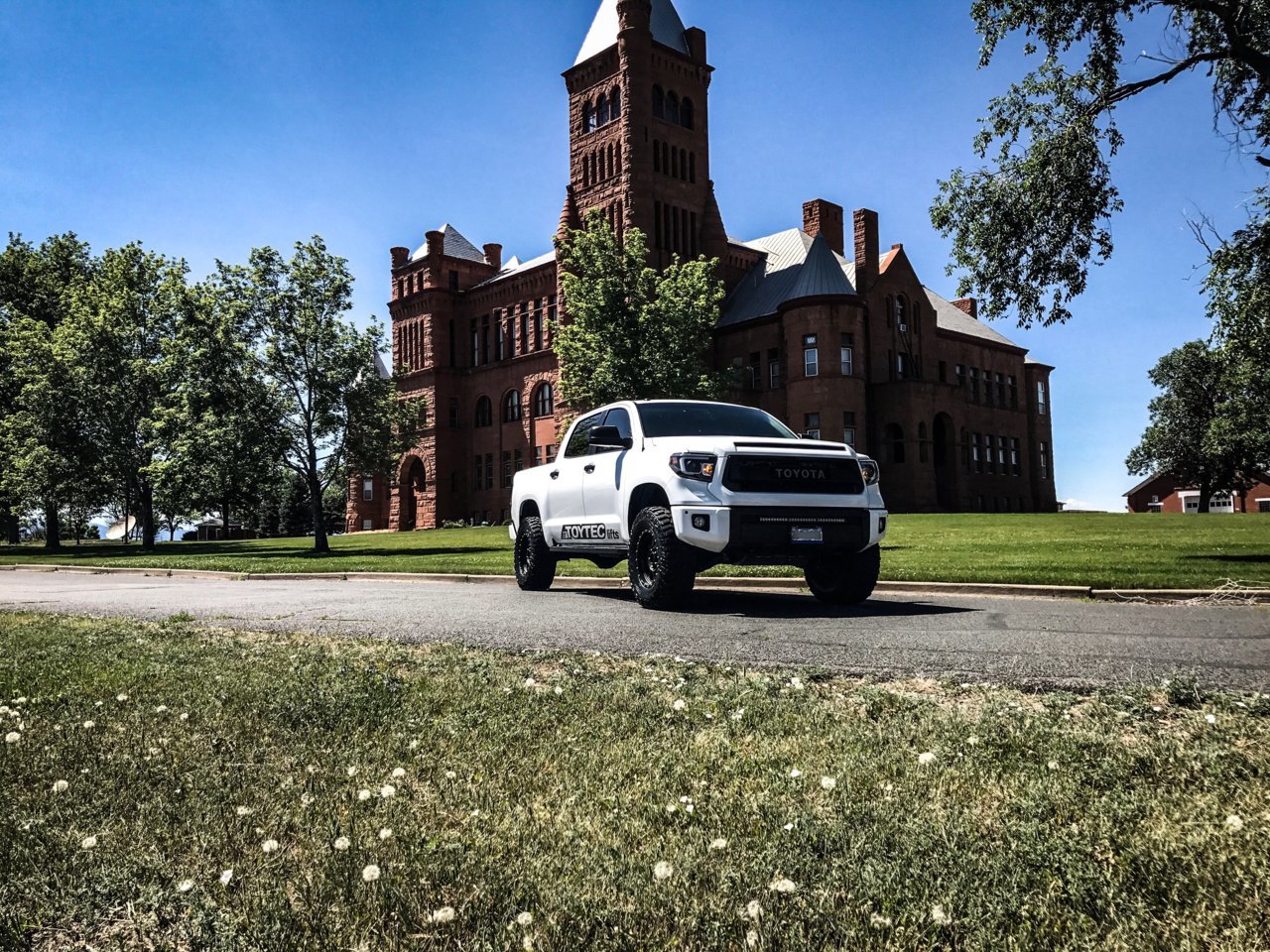

    #12550
    245
    Jeff
    Oh damn... What size are your tires, my man?! I've got those wheels on order. Can't hardly wait!!!

    >21
  19. Feb 19, 2018 at 5:47 AM
    42,447
    Dang that's a nice color. What color is that??? (GO WITH TOYTEC)

  21. Feb 19, 2018 at 6:02 AM

    That’s not mine, but he’s running 35”
