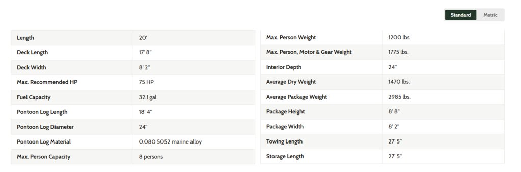

    I have a 24 Tundra Limited. It's my first ever truck. I'm currently researching boats and will soon purchase one. I know nothing about hitches. Which one should I buy and why? Money is not an issue, I just want something that will work well and be dependable. Are they all the same? I see that some are adjustable and some are not. Any reason to buy one over the other?
    Edit: I'm considering buying this boat and whatever trailer Bass Pro tells me to buy for it: https://www.basspro.com/p/2024-sun-tracker-bass-buggy-18-dlx

    Working from memory, so I might be mistaken, but I think the owner manual suggests a weight distribution hitch for towing over 5000 lbs. The stats on that boat from your link have it at under 3000, so you should be good from that aspect. However, it also shows that it's 27' 5" long, so an anti sway hitch may not be a bad idea.
