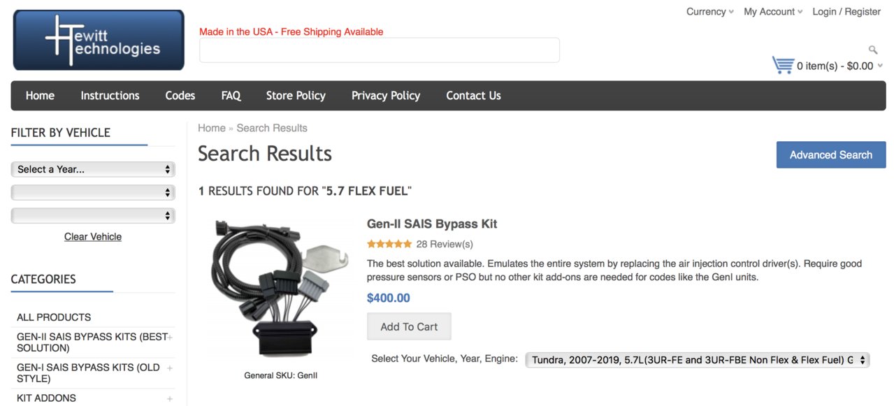

    It seems there is no option for the 5.7 Flex Fuel engine. Or am I missing something.

    Just did a quick search at Hewitt Technologies, here is the result... Is this what you are looking for...
    HewittTech01 and tnbndr like this.
