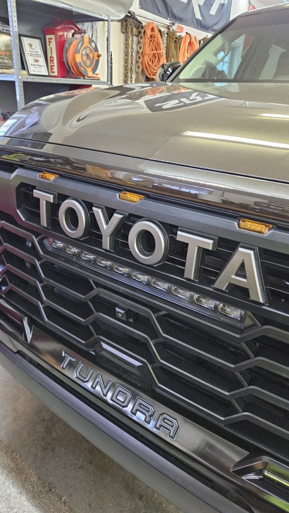

    OEM grill, under $200 from Sparks parts. Plus shipping, lights etc. Installed it myself. Easy but time consuming. The real expense with this particular grille is the lights, switch, relays & wiring involved. And depending on which grille you are replacing, a front camera bracket if your truck has one. 20250116_161214.jpg
