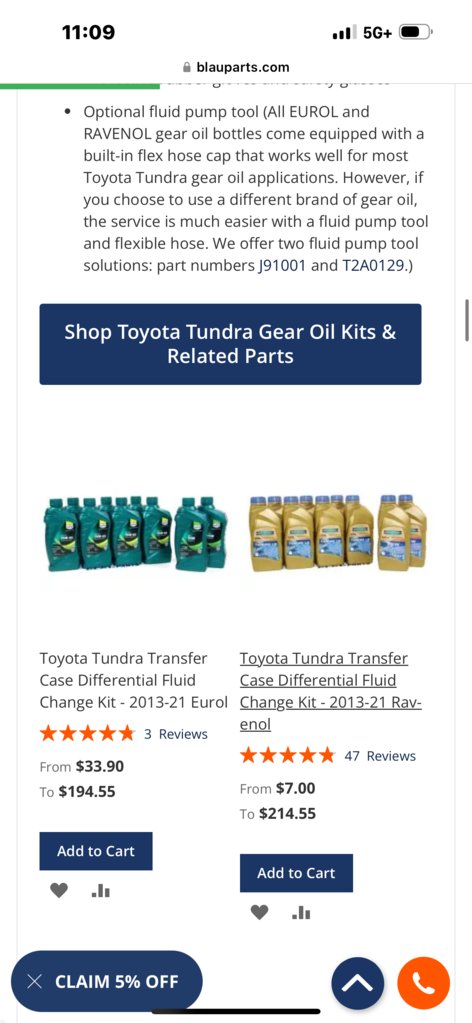

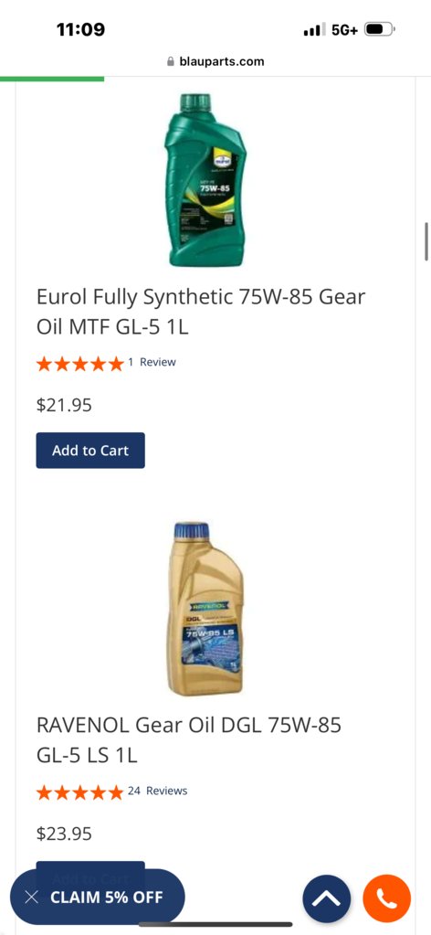

    The gold bottle (Ravenol) has a limited slip additive which you do not need for a truck with stock diffs. That appears to be the only difference as far as I can see.

    Your 2019 does not have a mechanical LSD, so either option is fine, but you don't need the more expensive one since the additive does nothing for your open diff.
    Your 2000 may have an actual mechanical LSD, so you would want the LS additive for that truck, but that is not what this question is about.
