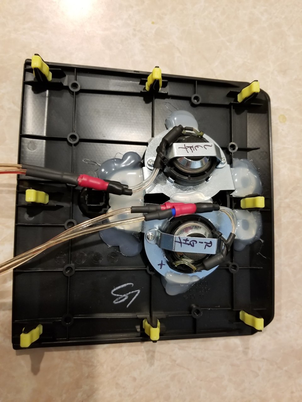

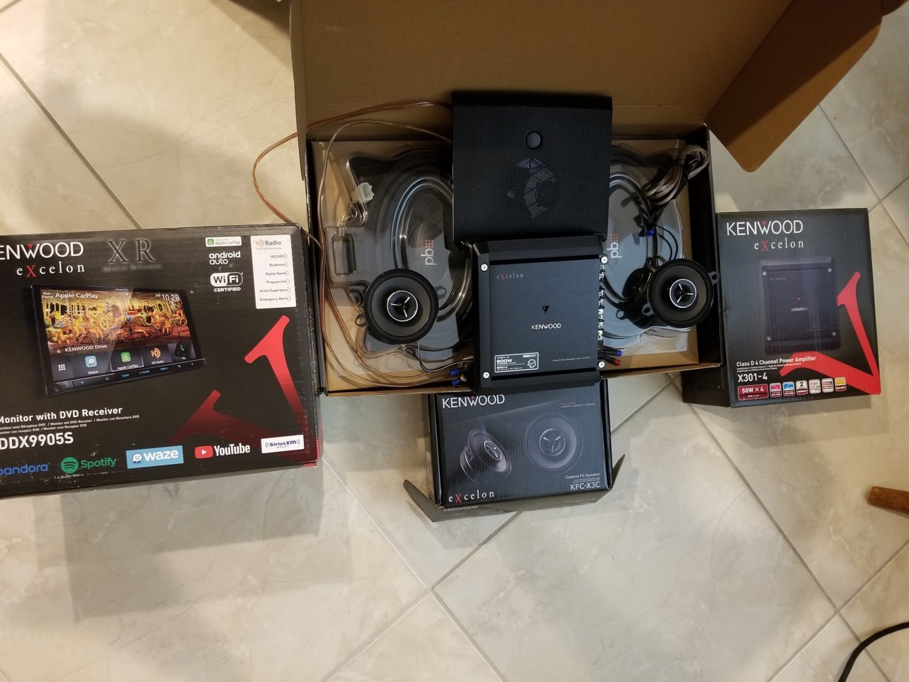

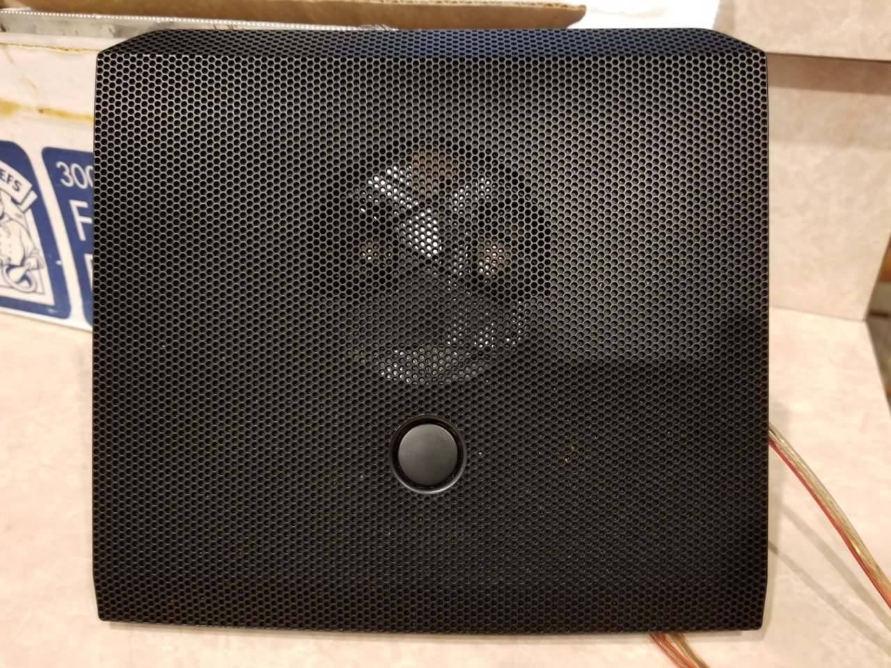

    This is my setup with no rears speakers. the X3C fits fine and flush but using only one screw. 20191203_203639.jpg 20191203_203112.jpg 20191203_202909.jpg
