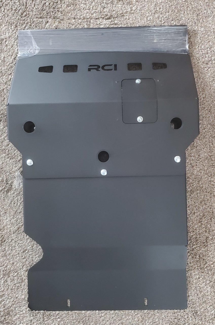

    I thought the trd plate does have access?? If not i vote rci

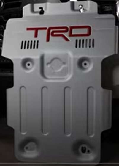

    When you say trd skidplate , im envisioning this

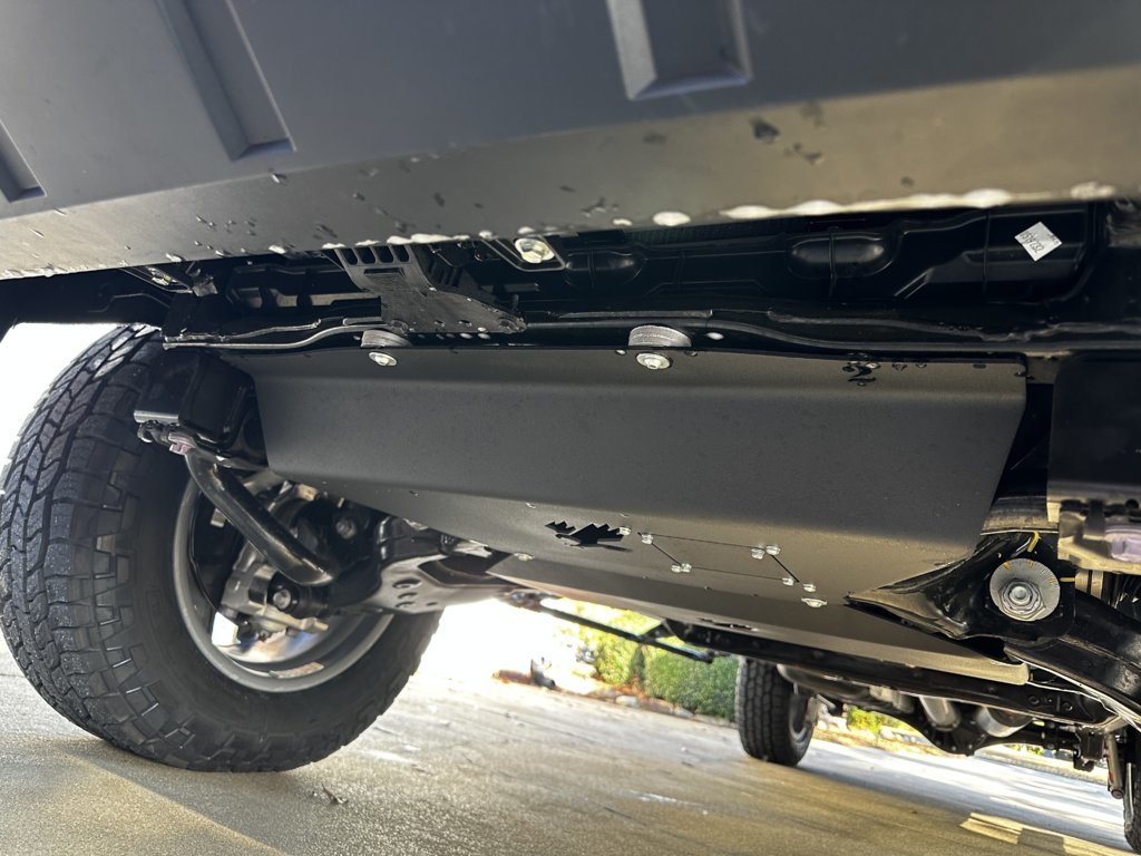

    I have a '24 Tundra Limited with TRD OR package. I did purchase the TRD full skid plate & Miller Cat Shield from my Toyota dealer. Got good prices on both. But now service is trying to tell me that although I have free oil changes, they want to charge me for removing and re-installing the skid plate. I said what... you sold me the skid plate. What does it take, a few minutes to remove it.
    So I have this auto tech guy who lives close by and is a master with fabrication. I asked about making an access port like they do on the aftermarkets. No problem as long as he gets the correct location, etc. to make the access points, otherwise, I take the TRD plate off and look for a different solution. The 4 Wheel Drive parts store nearby said I wouldn't like the AM shields as they rattle too much. Haven't talked with anyone who has the AM shields in, so can't confirm that statement.
