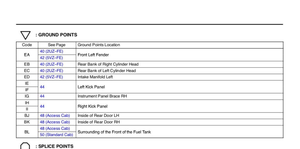

    This is taken from a 2002 AC truck's exploded. Figure it may help put pics to words. This is best I can trace it from the pic, cable and how it splits is in green.

    And honestly, I think it may extend farther, but the lines in the diagram made it hard to tell. Final termination may be as follows?

    It does. If you look at it on the truck, it splits down at the bottom with two main trunk lines, one on each side of the engine, and one that runs up into the firewall and splits out to a bunch of places after that. Your diagram actually shows all the ground wires, but only part of it highlighted.

    Looks similar enough to a 2/2.5 gen wiring. The wires from the battery (positive/negative/fuse box) go into a fat wire loom like this.
    The ground wire from the battery (follow YELLOW dotted line) directly connects to what is circled in RED where it pops out of the wire loom and connects to the engine block:

    On my 2000 4.7, the ground cable dives into the harness loom up top close to the battery, then emerges at the bottom of the loom near the middle / back of the engine. It attaches to the engine block down low and way in the back close to the trans on the drivers side. I replaced the original ground cable in a Subway parking lot in Yukon, OK. Well, more like bypassed it, the original is still in the loom, I ziptied the new one to the outside of the loom as the original could not be removed easily. And it’s longer than the numbnuts behind the parts counter says it is. Like 5-6’ long.
