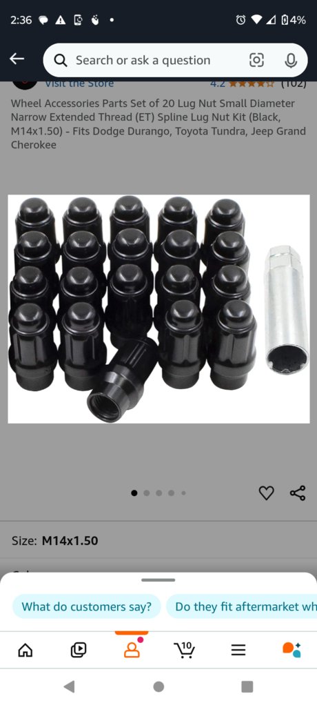

    Screenshot_20250110-143642.png McGard for wheel locks, look for extended thread lug nuts to make sure you have enough thread engagement on the studs up front. You don't want to lose a front wheel on the road. Even better is to replace the studs with longer studs from IIRC correctly, Blackhawk out of Japan. You can search this site and find a thread about them, the part number, and the source. I purchased my extended thread spline version from Amazon and they are okay, but I will eventually replace the studs to achieve maximum thread engagement.
    Here:https://www.tundras.com/threads/the...em-lugs-aftermarket-studs.76918/#post-2765793
    Keep in mind that not all wheels have the same lug nut seat design and it is critical to match it.
