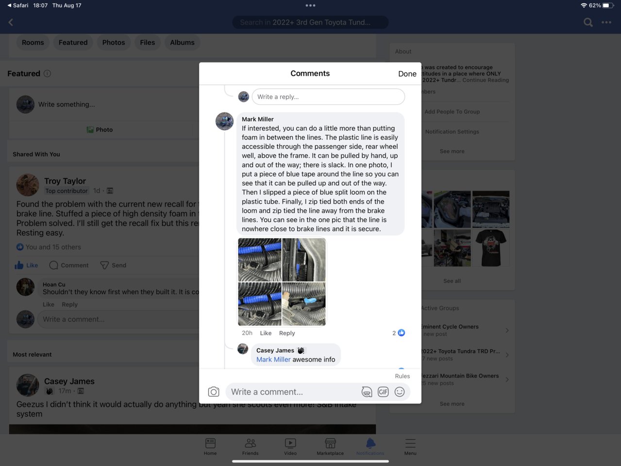

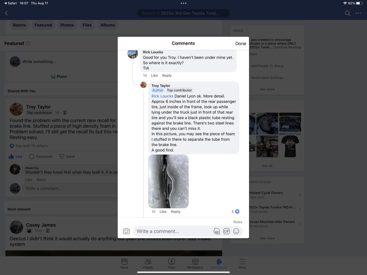

    The notice says "plastic fuel tube that is installed near metallic brake lines"........crawl under your truck and look for any brake lines that are near the gas tank (Right hand side of truck). Last time I was under the truck I don't remember seeing there being too many places that occurs (likely on top of the frame rail and bottom of the bed). If you can't find it or see that location then probably the only way you'll actually see it is to drop the tank which I would assume you aren't going to do that. As others have said the safety recall would have said to stop driving it if Toyota thought you should stop driving and park it. Take some pic's while your under there and report back what you find!!! Can't be too many places there is a plastic fuel line and brake line near each other (very likely the top of the frame rail and can probably see it right above the tire).

    I put a FB link in an earlier response to the OP that has more details. A dealership described it to someone who, in turn, identified it on his vehicle and started posting so people knew what to look at. I found it on mine yesterday.

    LOL….there are over 20 comments so no. However, here are two that have good info:
